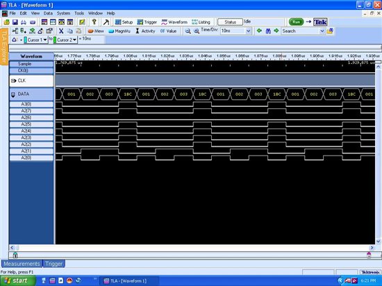

In my design I use the TLK3132 device and I have the following situation:
I have external H/W loop and the Self Test is working properly.
Then I de-activate the internal Self Test and I send a specific pattern at the TxD inputs (TBI mode).
At RxD I don't receive this specific pattern but instead I receive random data.
Could you indicate some possible issues that could lead to this behavior?

  • Hi Mike,
    I am using TLK3132 in 10-bit serdes (no 1000BASE-X) more, interfacing a Spartan6 FPGA.
    FPGA sends traffic to and receives data from TLK. TLK line interface is looped back with a dedicated crossed cable.
    When using "MACRO_BS" (see below) data output (RXD, RXC_0, RXC_4) from TLK are "invalid", seem to produce a random, noisy signal.
    When using "KALK_TEST" (see below) that uses internal test generation and analysis, data in TLK output seem pseudo-random as expected.
    See below also a download of all registers of TLK, to check if chip is well configured. Our target is to use the chip in 10-bit, serdes mode (not 1000BASE-X), JC disabled. All clock (TXCLK, REFCLK_P/N, RXCLK) are 104 MHz. Please consult if configuration is ok or what further checks we should perform.
    Thank you for your time!

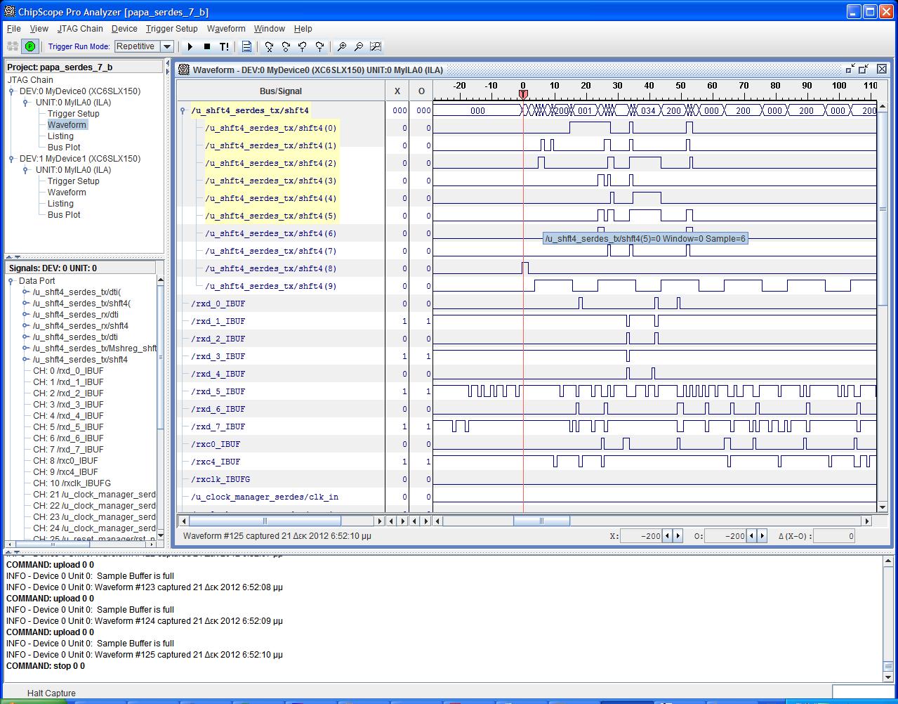

    Please find attached some snapshots taken from the lab.
    In image "snap_data_from_FPGA" you can see the following :
    -  u_shft4_serdes_tx_shft(4)(9:0) --> data sent from FPGA to Serdes in pins txc_4, txc_0 and txd(7:0) with txclk_0.
    -  rxd_0_IBUF .. rxd_7_IBUF, rxc_0_IBUF, RXC_4_IBUF --> data sent from Serdes to FPGA
    Note that this image is not static in time, but time-varying. In image "snap_data_from_FPGA_a" you can see a zoomed-in view of the same case.
    In images "snap_data_from_internal_generator (_a)" you can see case where data are still sent from FPGA to Serdes, but Serdes is programmed to generate an internal pseudo-random test pattern, which is presneted at Serdes output port (rxd(7:0), rxc_0, rxc_4 with rxclk_0).
    snap_data_from_FPGA
    snap_data_from_internal_generator_a
  • Hi Antonis,
    Do you have the serial transmit and receive of the TLK3132 looped on themselves? If you refer to Table 2-2 in the TLK3132 data sheet it will help you configure the device for the mode you want.
    In register 0x11 you have the 8B/10B encoder turned off and you also have comma detect on? Are you transmitting a comma at the start of your data? If so, are you using any kind of encoding scheme prior to sending data into the TLK3132?
    Mike
  • Hi Mike,
    I have an external hardware loopback, so yes the serial transmit and receive of the TLK3132 are looped on themselves.
    I don't use any kind of encoding scheme prior to sending data into the TLK3132. Is it error have comma detect on?
    Antonis
  • HI Antonis,
    You can have the comma detect either on or off in TBI mode. Currently you have it on so the receiver of the TLK3132 is looking for the comma to align to.
    Also, you can operate the TLK3132 without any encoding scheme but long runs of ones and zeros could effect the operation of the receiver. It is recommended to use the 8B/10B Encoders/Decoders that are built into the device or encode the data yourself externally. This also helps to ensure that your signal is DC balanced.
    Mike
  • Hi Mike,
    I made the following changes:
    1) I disabled the comma detect
    2) I enabled the internal loopback (Bit 0.14 of register 0x00 is HIGH)
    3) While I sent all zeros to all 10 parallel lines, I receive random parallel data. I believe that if I enable the internal loopback then long runs of ones and zeros do not affect the operation of the receiver.
    Could you propose what else to check?
    Antonis

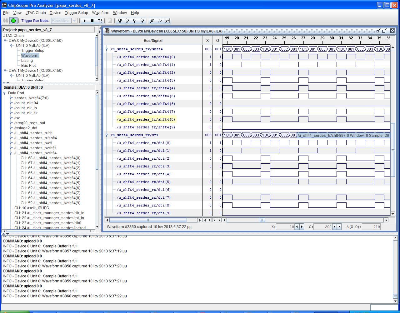

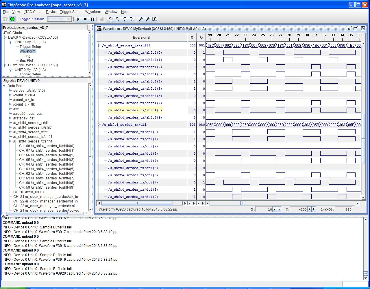

  • Dear Mike,
    We continued our tests using now NBI mode (AC coupling) and here are some results.
    We configured our system in NBI with 8b10b enabled, COMMA detection and alignment enabled (see file dump
    REGS_DOWNLOAD_thu10013.txt).
    The system with a simple 9-bit, 4-samples pattern 1BC-001-002-003 works fine (see snapshot
    serdes_NBI_pat1_pass.JPG, where, ..serdes_tx.. signals are sent from FPGA-to-TLK and ..serdes_rx.. vice-versa). Pattern "1BC" is selected as a COMMA characte for alignment and is sent once every 4 samples.
    The system with a slightly altered simple 9-bit pattern 1BC-001-002-030 does not work (see snapshot serdes_NBI_pat1_fail.JPG).
    Can you please give any suggestions on what might be the problem?
    Antonis

  • Hi Antonis,
    I was able to take a TLK3132 EVM today and configure it for NBI mode with comma detect on, AC coupled, and 8B/10B encoding. I used a reference clock value of 125MHz and a PLL multiplier of 10x yielding a data rate of 1.25Gbps. The rate mode was set to half for SDR mode and a PLL multiplier of 10x, if we were in full rate mode the PLL multiplier would have to be 5x. The Tx and Rx edge modes were set to rising edge, I believe yours was configured as Tx Edge Mode: Rising Edge and Rx Edge Mode: Falling Edge. I do not know if that will affect the data or if it is a requirement for your design but I used this as a starting point to try to get you a working script. See attached sonic script and test results:
    START
    CLAUSE 22
    WRITE (00,8000) //MAIN SYSTEM RESET
    WRITE (1E,9001) //SERDES_RATE_CONFIG_TX_RX
    WRITE (1F,5555) //SETS ALL CHANNEL TX AND RX TO HALF RATE MODE, IF YOU WANT TO USE FULL RATE MODE YOU MUST ADJUST
    WRITE (11,B197) //SETS GLOBAL WRITE, FLIPS TX AND RX DATA, DISABLES DDR, ENABLES RX_CLK,COMMA DETECT, 8b/10B ENCODER/DECODER, AND EDGE RATE MODE
    WRITE (1E,9000) //SERDES_PLLpCONFIG
    WRITE (1F,1515) //ENABLE PLL RX & TX, SETS MULTIPLIER TO 10X RX & TX
    WRITE (1E,900A) //SERDES_TX0_CONFIF
    WRITE (1F,0901) //AMP SET TO 750mV, NORMAL POLARITY, ENABLES TRANSMITTER TX0
    WRITE (1E,900C) //SERDES_TX1_CONFIF
    WRITE (1F,0901) //AMP SET TO 750mV, NORMAL POLARITY, ENABLES TRANSMITTER TX1
    WRITE (1E,9002) //SERDES_RX0_CONFIG
    WRITE (1F,1011) //SETS FULL ADAPTIVE EQ, COMMA ALIGNMENT ENABLED, ENABLES RX0
    WRITE (1E,9004) //SERDES_RX1_CONFIG
    WRITE (1F,1011) //SETS FULL ADAPTIVE EQ, COMMA ALIGNMENT ENABLED, ENABLES RX1
    WRITE (10,0800,0800) //DATA PATH RESET, ALL LINES TO FOLLOW ARE PART OF A VALID DATA PATH RESET, SEE PAGE 57 OF DATA SHEET
    WRITE (1E,9304) //HSTL_GLOBAL_CONTROL
    WRITE (1F,0000,4000) //TOGGLING HSTL RETRAIN
    WRITE (1F,4000,4000) //TOGGLING HSTL RETRAIN
    STOP
    Although this might not match your exact settings I triied to get as close as I could while adjusting what settings that I felt were suspect. Give this a try and let me know how it works out!
    Mike
