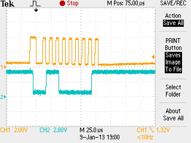

The Deserializer and Serializer link is ensured to be working, as we are observing I2C Clock and Data signals getting generated on the camera module I2C pins which
 is connected at the Serializer side. Also the address generated in the I2C transaction happens to be exactly same as in the case of direct connection to DM6437
(observed on Digital Storage Oscilloscope) . Only difference observed is with the edge on which the I2C data changes with respect to I2C clock.  We are not sure if
that is the issue.

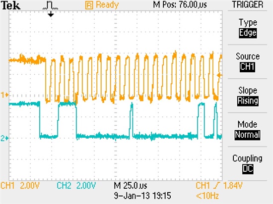

For your reference the waveforms are attached.
TEK0000-Issue.jpg -> Waveform captured with Serializer and Deserializer connected in-between.
TEK0001-Working.kpg -> Waveform captured with Camera  sensor directly connected to DM6347 EVM.
What could be the reason due to which the camera sensor I2C communication is not working in case of Serializer and Deserializer introduced in-between.

  • Hi Shailesh,
    Can you disclose the camera sensor used? I suspect the issue may be related to insufficient I2C hold time on the camera sensor. We had some customers experience similar issues related to I2C timing due to non-I2C compliant devices. Some slave peripherals use their own flavor of I2C protocol; such as 2-wire, serial bus interface, etc. and does not comply with the I2C standard.  Do you know the minimum I2C hold time for the camera? The tHD:DAT data hold time I2C bus specification is 0us (min) for this timing. The I2C module implemented on DS90UB903/4 complies with the I2C standard. Since the serdes link is a synchronous system, the I2C is based on the falling edge of the SCL clock. Unfortunately there are no registers to adjust the hold timing on Serializer side. However, our newer chipsets such as DS90UB913/914, DS90UB925/926, etc. do have I2C setup/hold time programmability.
    A possible workaround is to delay the SDA line on bus (additional hold time) by adding RC to slow the SCL -> SDA transition. They may also experiment with different I2C datarates to achieve this timing.
    Dac Tran

  • Hi Dac Tran,
    We may not be able to provide the sensor number over the open forum, but here are the sensor timing details as mentioned in its datasheet.
    tHD:DAT = 0 uS
    tHD:STA = 0.6 uS
    tSU:STA = 0.6 uS
    tSU:DAT = 0.1 uS
    all above values are MIN as mentioned in SCCB interface timing section of the datasheet.
    Which appear to be I2C compliant as per the tHD:DAT = 0 time mentioned by you.
    Also tried reducing the I2C frequency from 100KHz to 50KHz and 26KHz, but no change in behavior.
    The I2C communication worked properly in DISPLAY MODE. i.e DM6437 -> Serialiser  and Camera sensor connected to Deserialiser. But that's of no use to us.
