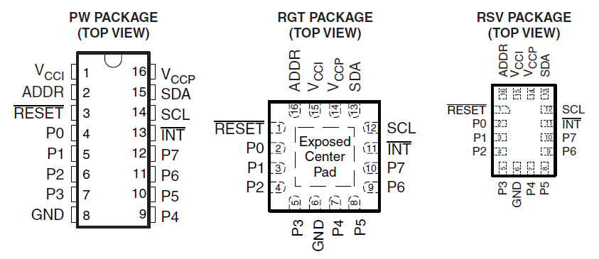

    For the given package datasheet doesn't show any GND pad in the center of the chip (compared to the other QFN package). Can you as well confirm that there actually is nothing there? Reason for asking is that I have free CU connected to GND in a pad under the chip. It doesn't contain any solderpaste and as said is just  a free CU area connected to GND. Please confirm if that could be a potential problem?.If there are no conductive elements on the bottom of the chip itself I guess not, as all stuff seem to measure correct around the chip => It for sure doesn't short any "official signals" to GND.
    Last but not least, Please confirm that datasheet RSV package pinput is double checked and correct.

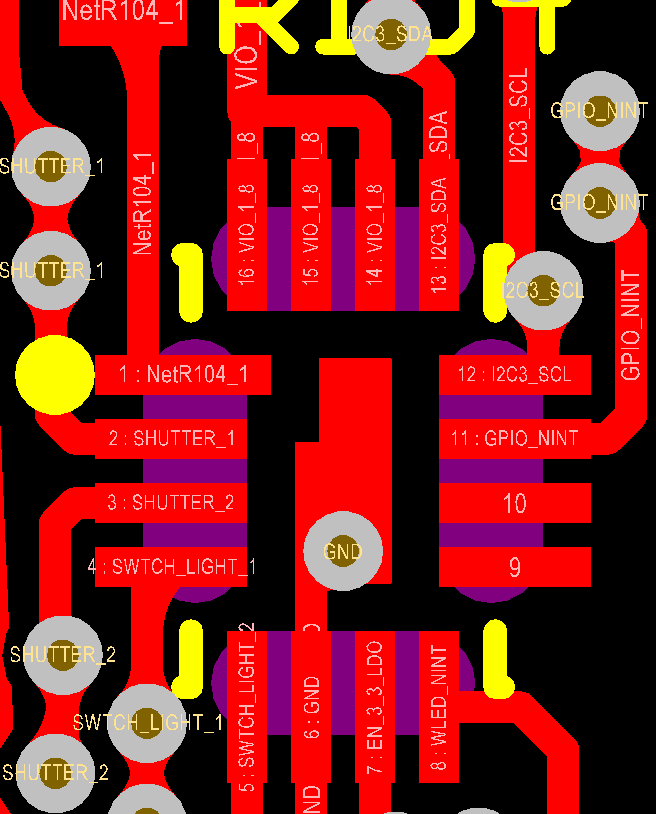

    With having an exposed copper pad under a package like this, you run the risk of shorting a pin to the pad.
    Can you confirm no pins are being shorted to GND from the pad?
    David

    1) Are you sure there is an exposed pad under the RSV package type as well? Reason for asking is that it isn't shown in datasheet, where exposed center pad only is shown for the RGT package type. Please see below figure cut from datasheet:
    2) I (un)fortunately was wrong in my 2nd post stating that we were missing coverlayer under chip. The layouter actually managed to get it in there. Please see below, where red is copper, yellow is assembly drawing, and purple is opening in coverlayer.All seem 100% correct to me, but hopefully I have missed something?
