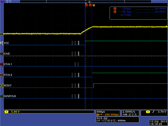

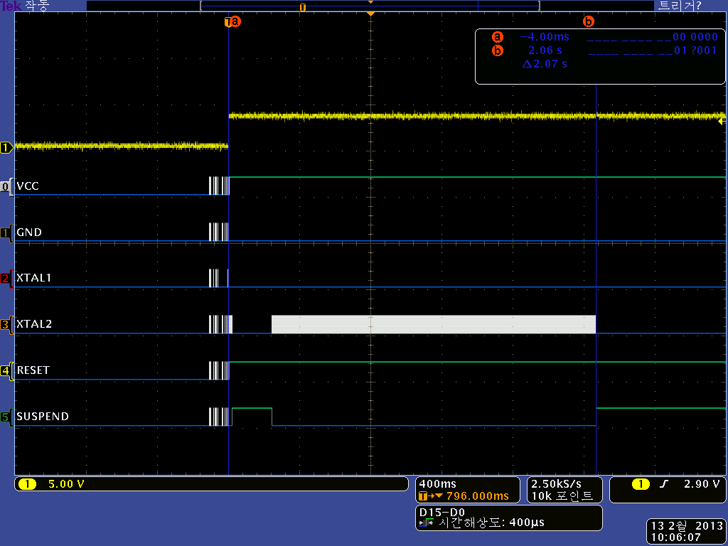

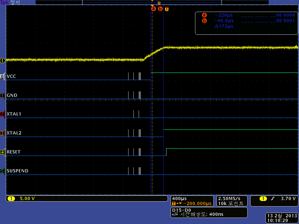

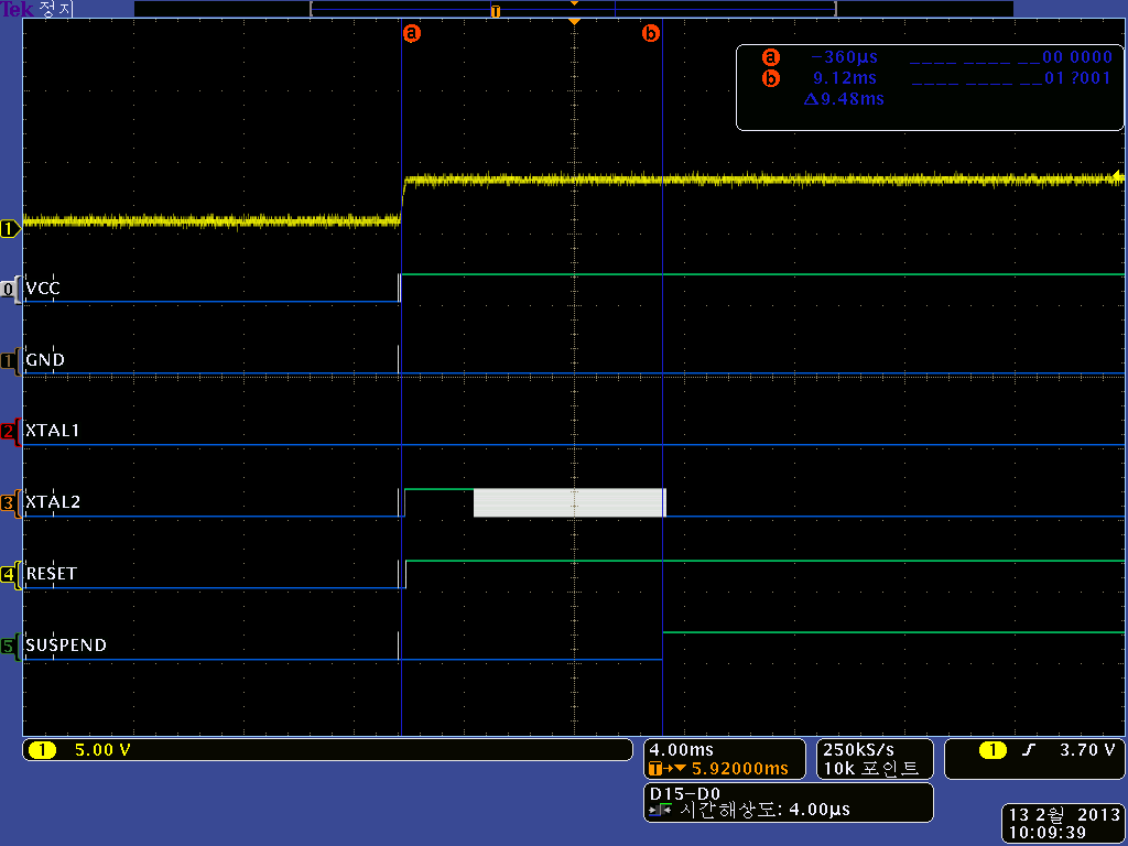

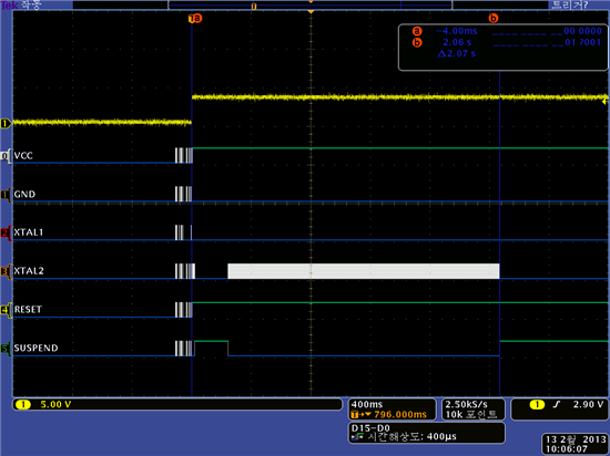

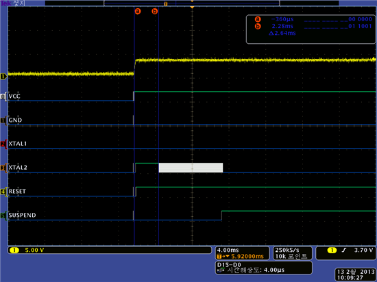

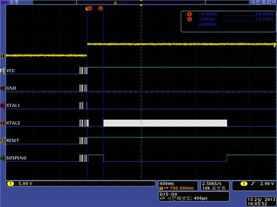

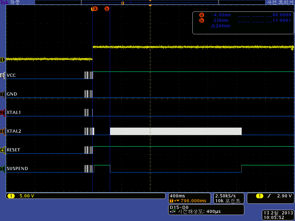

I have a design that is using two TUSB2077 USB hub chips and I have same problem on two TUSB2077.

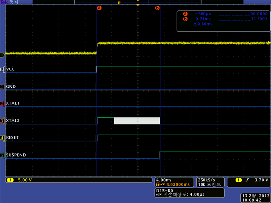

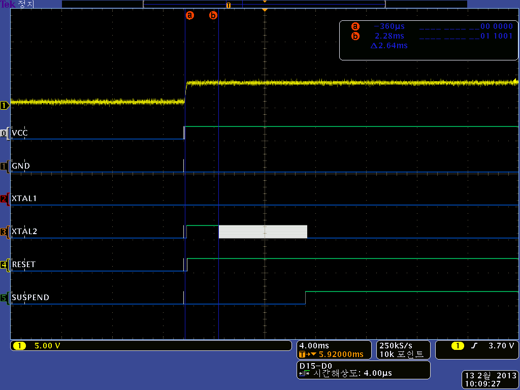

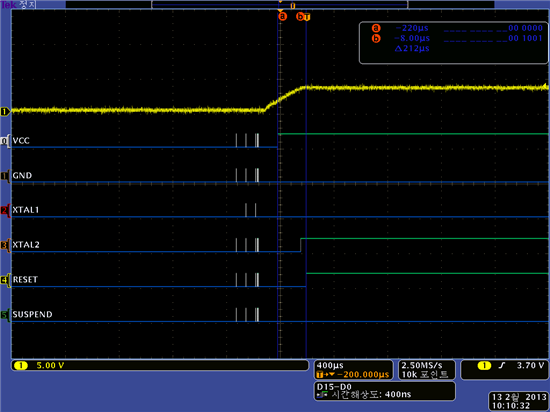

TUSB2077 chips does not work. And crystal work only during a short period of time when power-on or connected usb connector.
D + / - signals when using osciloscope I was able to confirm that four times the amount of data communication. And I got message "USB device not recognized" from my PC.
my schematic : https://skydrive.live.com/redir?resid=F38D5791557580B9!158&authkey=!AH697eXoiJkDlzM
