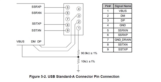

How should I connect GND_DRAIN pin with TUSB1310 chip?

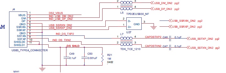

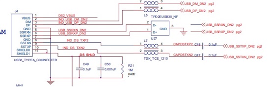

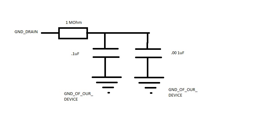

Ok, but I have asked about GND_DRAIN pin (In datasheet it is pin 7 ) but you have connected pin 4(gnd) and 7( gnd in your variant, but gnd_drain in mine one) to ground directly. Only two shields pins you have connected by this way. What is correct? And where should I connect pin 7? Same directly to GND?
If you have separate ground planes for power and signal, then connect Pin#4 to the power_ground and connect Pin#7 to the signal_ground, if your ground is the same for power and signals then you can connect Pin#4 and Pin#7 together.
