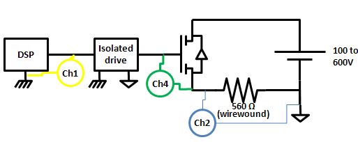

We have recently upgraded a design using the ISO7241CFDW by the newer ISO7641FMDW. However, we are running into issues when operating under high dV/dt.
The application is an isolated high side load driver that operates at up to 600V at 10kHz.

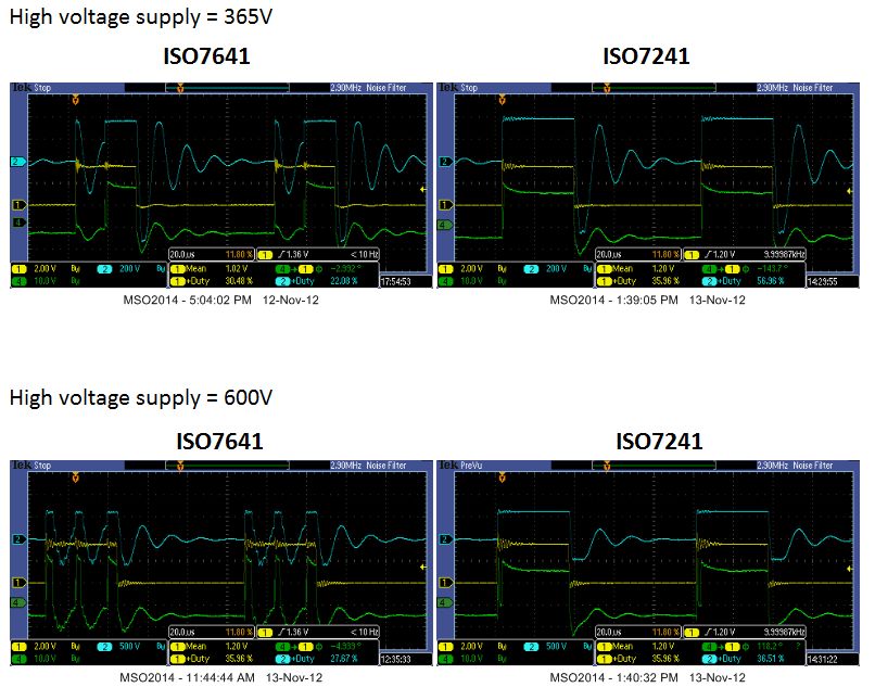

The issue consist of a wrong level transmitted by the isolator and appears only with the ISO7641 operating at voltages higher than 360V and hard switching condition (high dV/dt) as seen on screenshots below
When probing directly on the isolator output, it can be seen that the ISO7641FMDWincorrectly transmits the PWM information. Isolator supplies (3.3V on primary and 5V on secondary) remains constant during the test so it can be assumed that this is not a "fail-safe" output (which happens to be low on ISO7641 and high in ISO7241)
The same test are run with both isolators (and some competitors isolators) and only the ISO7641FMDW shows this problem.
Has Texas Instruments identified this issue before? Are there any known workaround for this issue?

    Can you send a zoomed in screen capture of the first rising edge? We want to see what's happening during that pulse on channel 4.
    Also, how are you measuring these signals? I believe most oscilloscopes tie the grounds of the different channels together internally, so that may be something to consider.

  • Dear Jason,
    Primary side waveform (Channel 1) is measured using a regular scope probe (non isolated, 1:10, BW 300 MHz) while secondary side waveforms (Channel 2 and 3) are measured using differential probes (isolated, 1:500, BW 100 MHz) to avoid grounding issues

  • Hello Raul,
    our test engineers have the following suggestion:
    Since the issue is occurring during high dV/dt it may be the ISO7641FM is responding to transient energy coupling onto inputs given the ISO7641FM does not have input filters.
    Hence, could you consider using the ISO7641FC in your application which includes integrated noise filters?
    Thank you, Thomas

  • Hello Raul,
    you are correct, the ISO7241M has no noise filters and most likely will give you similar problems. The fix of high DC common-mode between GND1 and GND2 is currently under re-design. Frankly when i looked on your original scope shots I thougth at first that the ISO7641 lacks of drive capability. However, I have seen similar issue with opto-coupler design where large di/dt coupling into the inputs occurred.
    Unfortunately you are already advanced in your PCB design. Otherwise I would have suggested our isolated IGBT driver ISO5500. But for now please go ahead with the ISO7641FC if you can.
