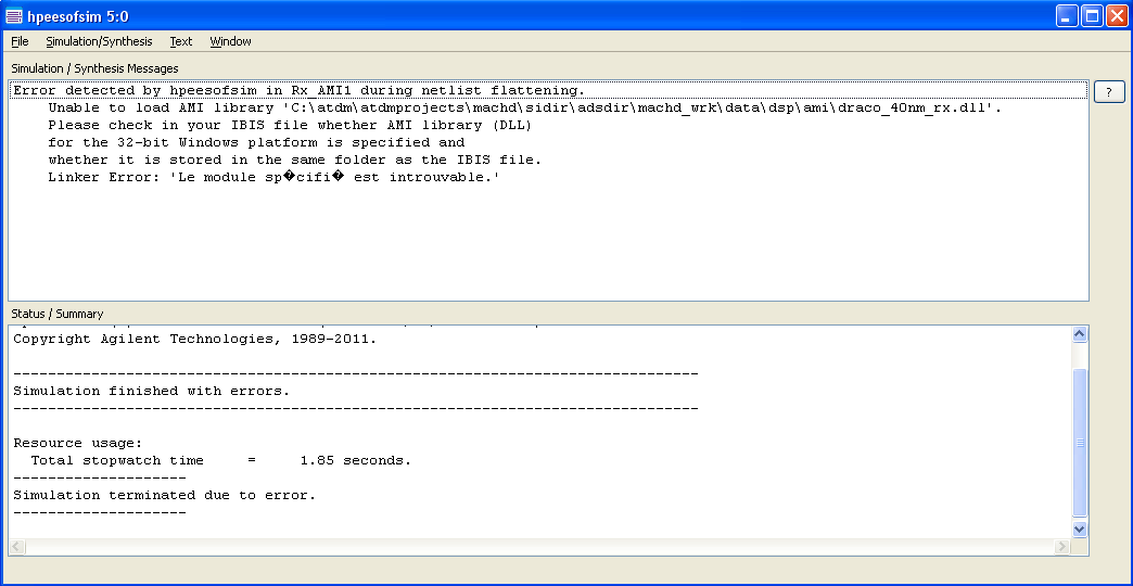

I design now a channel SerDes simulation between a DSP (TI ) and a FPGA (Xilinx ) and I have problems with the model of AMI DSP. You can find a copy of the error message when I run the ADS simulation. It tells me it can not find the DLL model TI while it is yet in the right place.
I tried to include another model AMI in the section [Algorithmic Model] of DSP IBIS (see line 87 $of file attached IBIS) and the simulation no longer generates an error. So the problem could come from the dll file.
The exact name of the version I have is: SerDesShannon_PCIe_SGMII_SerDes_AMI_Model_v1p03.
Is there a more recent version of this model?
Have you ever heard of a similar problem with this model AMI during a simulation in ADS?
