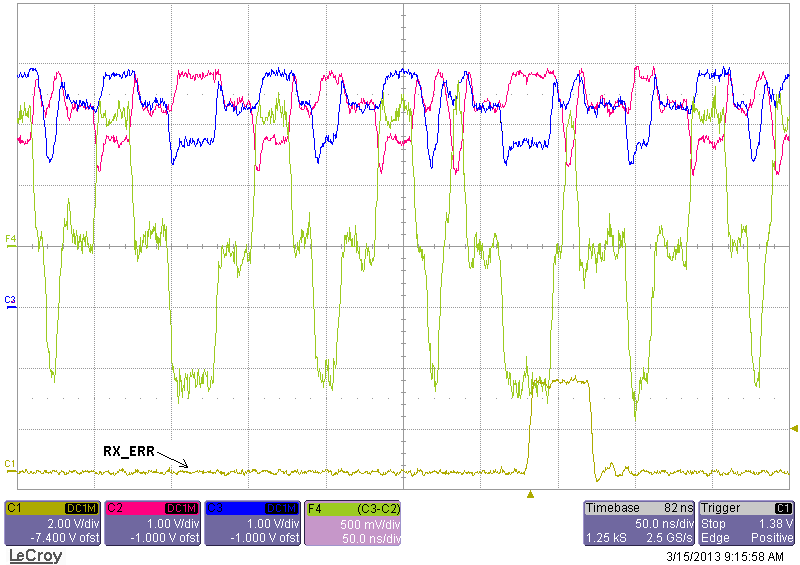

I'm testing ethercat communication in a custom board (broad cut&paste from ICE demo board). Everything is fine, except for frequent RX error at physical TLK110.
Ethercat diagnostic tools report "frame lost" increasing count.
I've tried these:
- decrease distance between PHY and MAGNETIC (less than 5mm)
- change terminating resistors values ( slightly less and more than 50Ohm)
- increase bypass capacitors value
- change magnetic type and manufacturer
- change Ethercat master
I can't see any valuable difference in data error rate.
I've double checked resistor values, clock signals, pull up/down, with no result.
Here you can see a oscilloscope dump when an RX error occurs:
RX_ERR in channel 1 is pin 41 output signal. Channel 2 and 3 are RX+ and RX- signals. Trace F4 is the difference between RX+ and RX-
 Differential signal seems fine to me.
This problem is going to  be a BIG issue. Any suggestions?
  • I believe that the receive errors are being caused by poor signal integrity of the receive signals.  The key will be to determine the cause of the poor signal integrity.  I understand that your design is broadly cut and paste from the ICE board, but could you provide a schematic for review?  That would be the best starting point.

    In our board TX signals are very close to the ones you posted. RX ones are not so nice...

  • Hi, please also change the following:
    1. R631 should not be there, I would suggest disassembling it.
    2. RBIAS should be 4.87kohm (it is 4.99Kohm).
    3. please also remove Z16 (ferrite bead) and place 0 ohm resistor. (we found ferrite beads sometime degrade the supplied signal).
    4. the 49R9 resistors ( R374,373, 402, 415) value should stay as they are.please do not assemble any capacitors in parralel
    5. RX signal integrity is dpendent on the link partner and the cable length.
    Aviad

  • Hi!
    The problem was caused by ferrite beads. As you suggested we've replaced Z16 AND Z18 with a 0R and the problem completely disappeared. Nice hit!
    I've checked and actually 0R are placed instead of ferrite beads in my ICE demo board, but this *IMPORTANT* update is not mentioned elsewhere. The only information about that is in BOM spreadsheet, very nicely hidden between tons of other unimportant stuff. Please, consider to update ICE demo board schematic and make a BIG REMARK onto schematic: DO NOT USE FERRITE BEADS.
