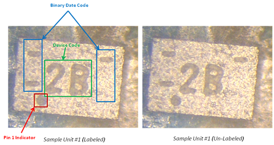

I am using three TPD3E001 in DRY-6 package on my design and the data sheet doesn’t show any marking for pin1.
As Murphy’s law strikes, the CM had 50% chance to put them the wrong way, which of course he did.
The explanation on page 15 of the data sheet is not very helpful.
 Please advise where pin1 is. I can debug the board without those but I need to ship fully functional boards in the next few days.
