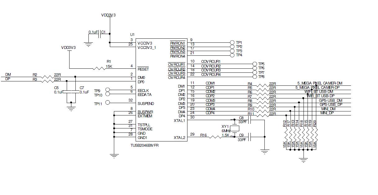

Thank you in advance ,
Not detecting TUSB2046B in my USB port.
For clarification attached my circuit.
please help me

Thanks ,
1uF capacitor done, 1.5K resistor from DPO to 3.3V done , connected EXTMEM# to 3.3V
sure that XTAL1 and XTAL2 receiving a 6MHz signal perfectly.
please see this
Can you provide your updated schematic?
Make sure terminals OVRCUR# are high.
Check your voltage levels.

Hello Arun,
It is still the same schematic posted before, there are still missing some components (1.5K pull-up, 1uf cap, etc.)

now i did manual correction ,
reset grounded through 1uF
still not detecting
DP0 must be pulled up to 3.3V, the terminal is not 5V tolerant, can you send scope captures of DP0 and DM0 at connection, also a scope capture of RESET# Vs Vcc Vs XTAL1 at power up.
