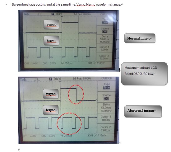

If you look at the status quo: vsync and hsync cracked screen waveform even longer.

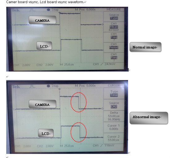

    LCD screen broken phenomenon occurs with non-periodic.
    CAMERA BOARD with LCD BOARD connection within 10 seconds or more than 20 minutes over time:
    And irregular.

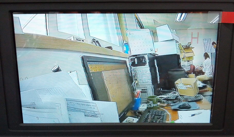

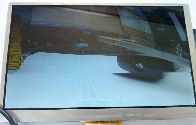

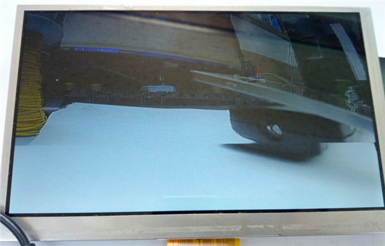

    LCD Screen Flashing, screen vibration, Video ON/OFF in the occurrence of such phenomena.
    1. Split this into two halves, the top and bottom of the image.(Lcd tearing).
    2. Screen vibration.
    3. Screen on/off .
    4. Vsync waveform.
    5. Rosenberger cable used.
    Thanks you.
     Thanks for providing the addtional details. It appears that the Vsync duration of the camera output (input to serializer) is changing between the "normal" and "abnormal" case. This leads to a similar shift at the LCD (output of deserializer). This may be the cause of some instability at the camera imager output.
