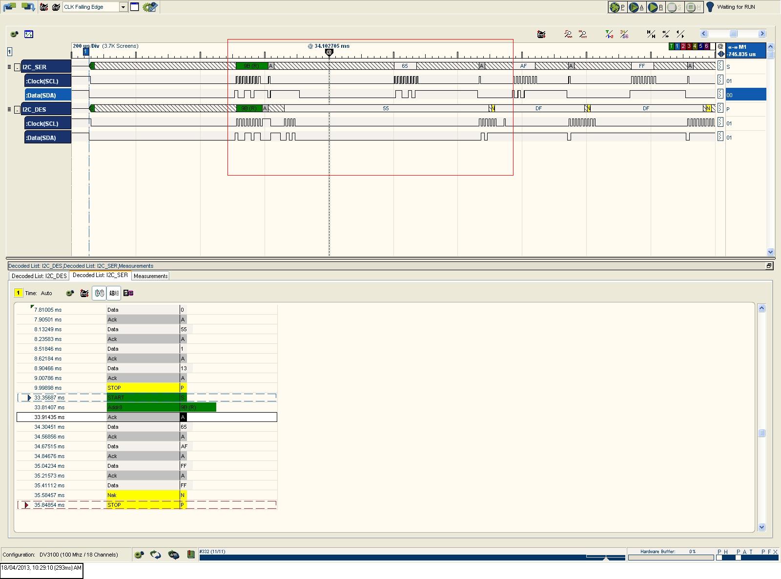

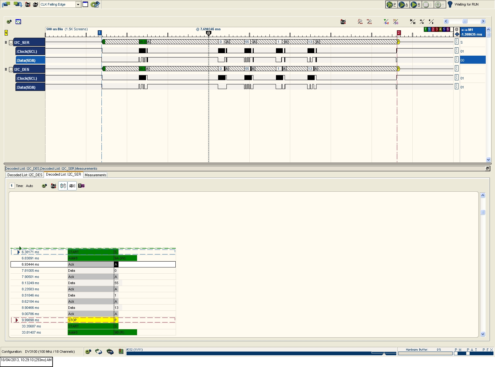

An example command (Bytes seen) has been provided within the attached file (Image insertion proivded poor quality) see screen shot of the logic analyser image highlighting the issue I am seeing. Logic Analyser connections are made at I2C_SER at the O/P of the Microchip Serial Analyser and I2C_DES at the O/P of the DS90UB904Q Deserialiser.
Disable Touch
Send: - 0x9A, 0x00, 0x55, 0x01, 0x13              This is sent O.K and timing seems O.K (Approx 1us delay between SER and DES clock pulses)
Receive: - 0x9B, 0x55, 0x02, 0x00, 0x13         Clock pulses are seen on the Des line, when 0x55 is sent by the AR1021 however these are not being re-produced on the Ser I2C bus and timing appears to become sparadic ?

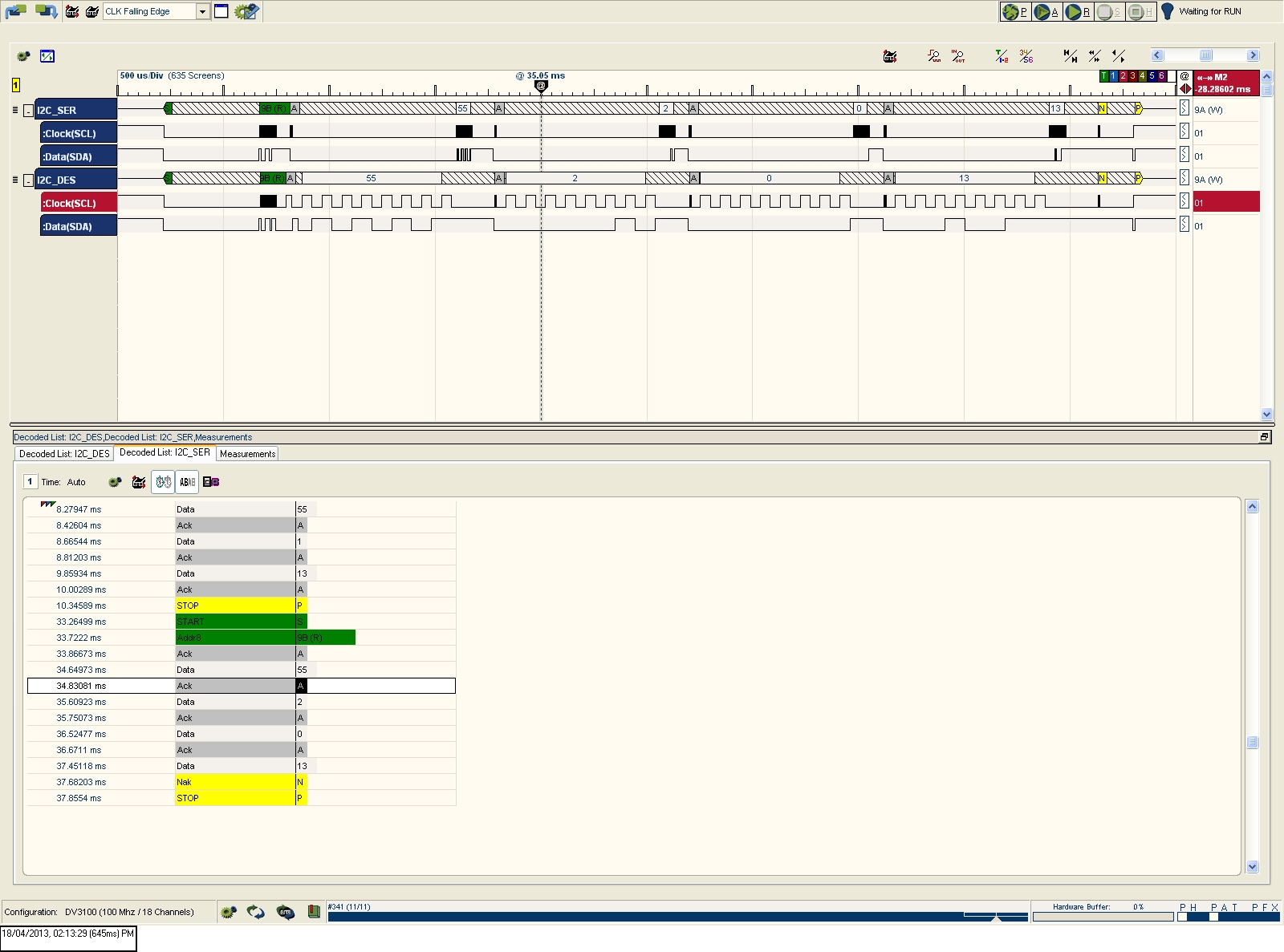

    I have found that it is possible to get the AR1021 to function correctly by pre-scaling the SCL clock line to 11 kHz (Lowest setting available). I managed to do this by setting register 0x06 to 0x5F on the DS90UB904Q. Please see attached image detailing a successful receive captured by the logic analyser which I have tried to add (Appologies if this has over written the previous one; however it is more relevant).
    The conclusions I have drawn from this is:-
    1) During a 'send' message both the Ser and Des appear to be almost in sync and only a very small propagation delay exists (In the order of approx 1us) and no errors are seen with both devices set to 100kHz.
    2) During a 'receive' message the Ser and Des appear to be out of sync. If you reference to the attached image what appears to be happening the Des generates the SCL pulse on it's local bus without the Master Ser having control of the SCL line. It appears as though the Ser is held by clock strecthing until the entire byte has been read into the Des, where upon the 8th clock pulse the SCL is released to the Ser so it can reproduce the data back to the master.

    I have again monitored the DES SCL & SDA lines with the logic analyzer, and what I have found is that the problem (missing a number of clock cycles) gets worse as I increase the SCL frequency on the DES (Via the prescale register 0x60); the results I found were as follows:-
    11 kHz = O.K All, 8 SCL clock cycles clocked out by the DES (Without a gap) and the correct data is transferred back to the SER
    33 kHz = Failed, A time gap is added after the 7th clock cycle, where the SER then transmits the 8 bits of data incorrectly, hence missing the 8th clock cycles after the gap
    50 kHz = Failed, A time gap is added after the 4th clock cycle (As seen), where the SER then transmits the 8 bits of data incorrectly, hence missing the 7th-8th clock cycles after the gap
    100 kHz = Failed, A time gap is added after the 6th clock cycle, where the SER then transmits the 8 bits of data incorrectly, hence missing the 5th-8th clock cycles after the gap
    125 kHz = Failed, A time gap is added after the 3rd clock cycle, where the SER then transmits the 8 bits of data incorrectly, hence missing the 4th-8th clock cycles after the gap
    I have tried another I2C device and this does function correctly at 100 kbps, and all the I2C timings and transactions are as per your description and matches what I see at 11kbps (Obviously the SCL freq is different), which does point to a compatability problem between the SerDes chip set and the AR1021 touch screen controller.

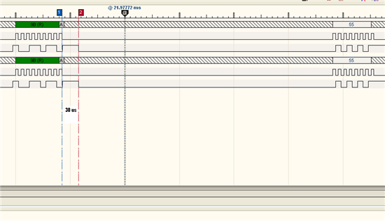

    I am unsure if it is the AR1021 that is holding the SCL line low or the Des, and what I have done is to By-pass the SerDes chip set and run the same command (From a GUI supplied for the touch screen as part of the Eval kit) as I have shown in the previous images and what I have found is that there is a delay of approx 500 us after sending the Read address (0x9B) before starting to clock out the data from the AR1021 and I'm wondering if a delay is needed at the DES end if that is possible (See Attached image) ?.
    Also I have noticed that the AR1021 after sending it's ACK to the Read address 0x9B (Low on SDA on 9th SCL) it drives the SDA line high before taking it low again ready for presenting the first data bit on SDA. The time from SDA going high (After ACK) to going low for first bit of Data (0x55) is measured as 30 us.With reference to the AR1021 datashhet section 5.7.2 P24 (See attached image)

    Based on the information you provided, the AR1021 is controlling the I2C bus in some manner during the read phase. This is shown on the ‘0842.30us_5F00_delay.png’ where the I2C SCL/SDA lines are driven low after the 0x9B read byte; otherwise the I2C lines would be released (idle high). The AR1021 datasheet section 4.4 Master read bit timing step 4 mentions:  Master monitors SCL, as the AR1021 may be“clock stretching”, holding SCL low to indicate that the master should wait. Unfortunately, the I2C controller on the DES does not have this type of ‘intelligence’ to sense the bus activity. Therefore, there will be some sort of bus contention/conflict which will result in interoperability issues. There is also no option on 904 to force a delay in the read operation other than the SCL prescaling.

    With reference to your previous post; I agree and it does appear to be the AR1021 pulling the clock line low (After 30us) which in my understanding is a function of clock stretching if the AR1021 device isn't ready to respond, however it does initially start to respond with the first 4 clock cycles before either the DES or AR1021 pull the SCL line low . The I2C_DES SCL is initially released approximately 44 us after the SCL is initially pulled low to allow the 8 clock cycles to begin. I have opened a support request with Microchip on this problem to clarify the exact operation, and hopefully explain what is happening with the AR1021 so we can nail down the problem.
