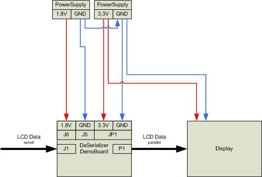

  • Hi Thomas,
    Do you have any pictures or schematic information that you can share? Which ground connections are you changing (display, cable, etc)?
  • Hi Ryan,
    Here a simple sketch about the test setup:
    The connection "LCD Data parallel" is done by an adapter board from ES&S (flatcable to ffc converter).
    With this test setup I have this pixel flickering, when I connect an cable from GND to VSS of JP17, the flickering is reduced, but it is still exist.
    I have to build up the test setup, then I will send you two pictures about what the display shows.
    Best regards
    Thomas

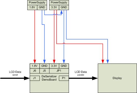

  • Hi Ryan,
    I have changed the Power Wiring as shown at the next picture.
    With this setup, I have much less pixel flickering.
    The wiring between your DemoBoard and the display is approximately 8 - 10 inch and there are three connectors in this line ==> could this be the problem ?
    An other question: can I use the i2c bus at the DeSerializer also for other slaves, like a touch controller ?
    Best regards
    Thomas
