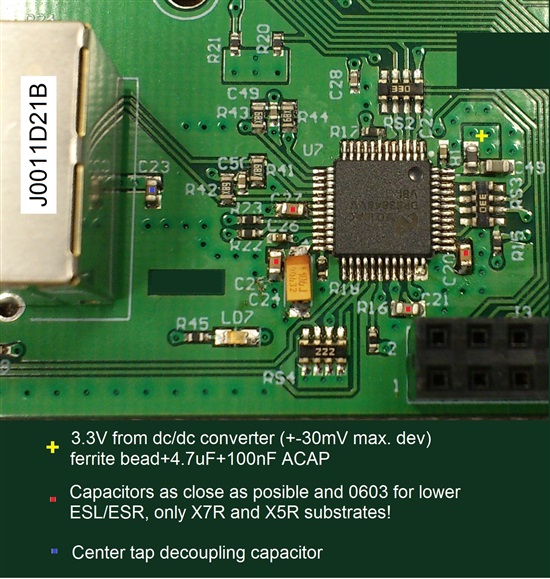

I attach a photo of the board:

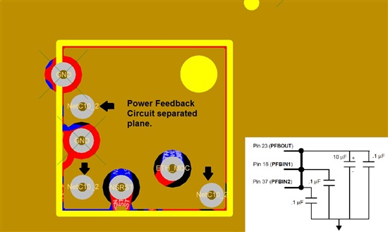

Following the recommended guidelines:
4 layer board: from top to bot: 1-signal/gnd, 2-GND, 3-Power (in figure), 4 signal/gnd.

The out of the 1.8V regulator it is on range but is lower than the good one, however the Rbias voltage it is low.
What is the reason?, Is this the origin of the failure?,  How could I solve it?

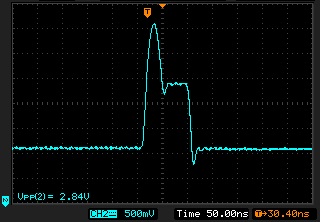

    The issue observed is in my opinion due to "low level" causes:
    - Between several circuits with the same BOM and Layout, same firmware (web server) at a same location in the network: certain circuits response to ping and web services and others no.
    Following all the elements of the network seems to the "blocking" elements are the gigabit switch (first element encountered), and investigating a bit more the three gigabit elements (one per one appart) rejects the packets of the dp83848I (only in the fail boards of course). May be casuality the gigabit feature?, the other common feature is that all are Netgear. But note that the same circuit with a controlled substrate works well (components quality may be slightly better, but not in critical ones).
    I have some experience into RF and microwave world and in my opinion a substrate with a small variation on its permittivity would not produce appreciable changes at this frequency in special with coplanar lines and differential pairs.
    I have no idea of the cause, the interfaces works barely well but not enough.
    Link pulse shape seems equal between valid and failing boards, the differential pulses (link and carrier) are small in failing boards about 160 mVpp.
    I attach images for 1/2 link pulse (positive). The blue one corresponds with the valid boards, the yellow one with the failed boards.
    What about the voltages on the 1.8V regulator and Rbias? Seems that all failing boards have less voltage with the same tántalum. Is this dependant of the loss/parasitics in the substrate?
