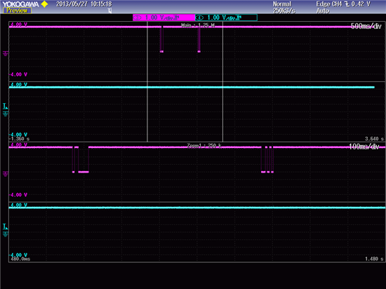

  • My customer change how to register bit, but trouble output waveform is no change.
    Could you advice and help please?
    ■DLL/DLH setting
    [Before]
    base_adress+0x03(LCR)write(Present value |= 0x80)(LCR[7] = 1)
    base_adress+0x00(DLL) write 0x03
    base_adress+0x01(DLH) write 0x00
    [Now]
    base_adress+0x03(LCR)write 0x80(LCR[7] = 1)
    base_adress+0x03(LCR) write 0x03 (LCR resetting)
    【Trial result】
    ・Occur trouble output waveform at TX in DLL access timing.
    ・Occur trouble output waveform at TX in THR access timing.
    Attached file: Purple line is trouble output waveform.

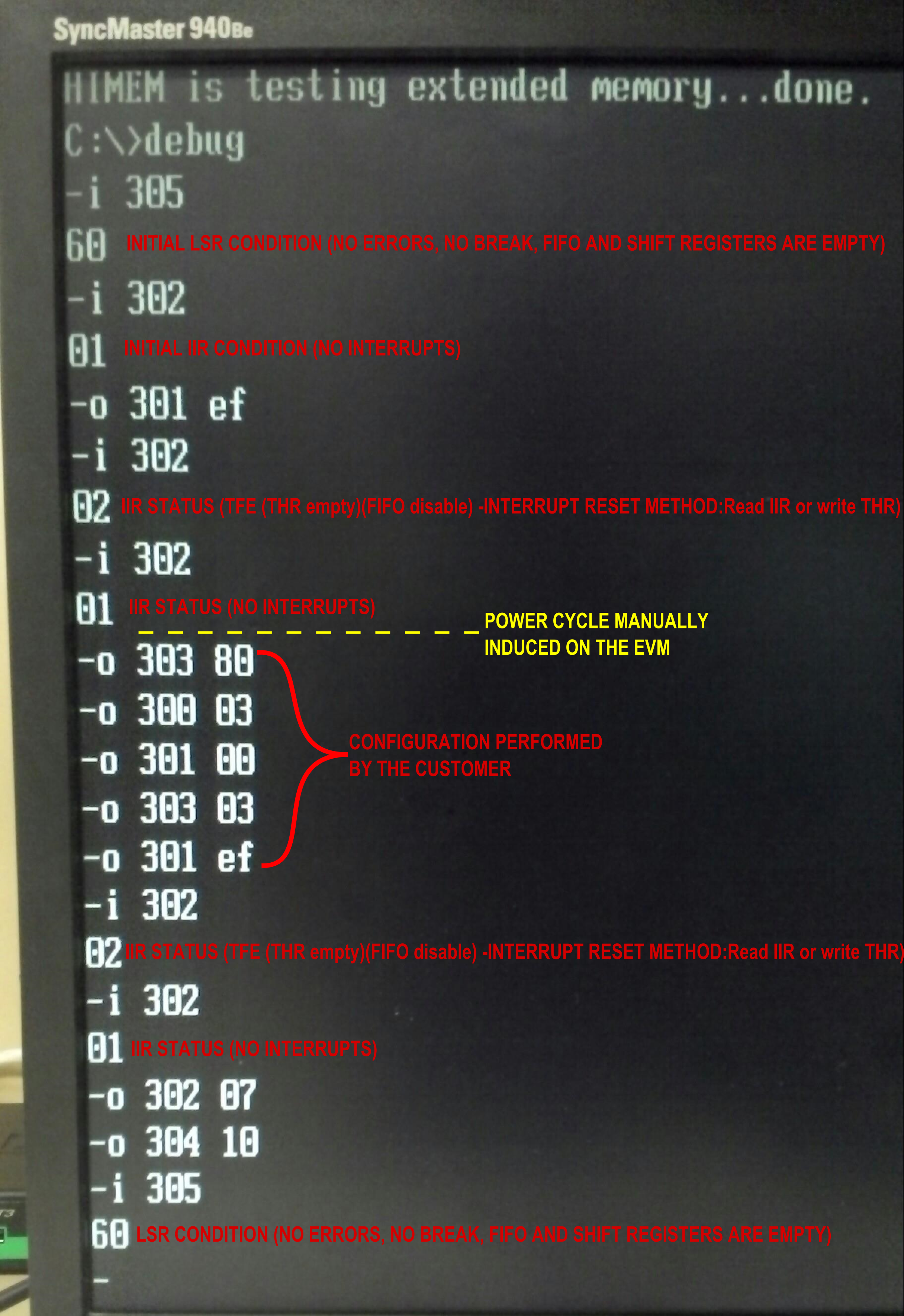

  • Hello Miyauchi,
        Let's try the chip configuration since the beginning, You only add the loopback feature to Your configuration ( for a normal operation, just omit the line where MCR is equal to 0x10).
    Turn ON the UART system (or power cycle it) and make sure You are NOT accessing to the configuration addresses before the following steps:
    LCR (Base_Address + 0x03) = 0x80
    DLL (Base_Address + 0x00) = 0x03
    DLH (Base_Address + 0x01) = 0x00
    LCR (Base_Address + 0x03) = 0x03
    IER (Base_Address + 0x01) = 0xEF
    READ IIR (Base_Address + 0x02)
    FCR (Base_Address + 0x02) = 0x07
    MCR (Base_Address + 0x04) = 0x10
    --------Now test the functionality, sending and receiving is done by the same channel (Base_Address + 0x00) and checking the LSR (Base_Address + 0x05).
    I attached a successful example using the EVM of the TL16C752C,  running on DOS (Base_Address = 0x300).
     IMPORTANT NOTE: I omitted some of Your steps because You are using the default values (see the table 2, page 11 on the datasheet) .-
    Diego.
