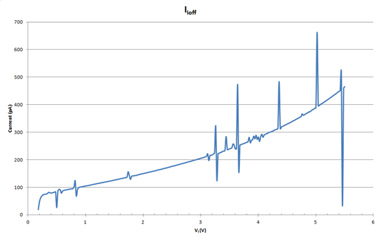

Would you please specify the max. leakage current for VCC=0V and VI=-0.5V...+5.5V of the TCA9539 (-> power supply voltage switched off) ?

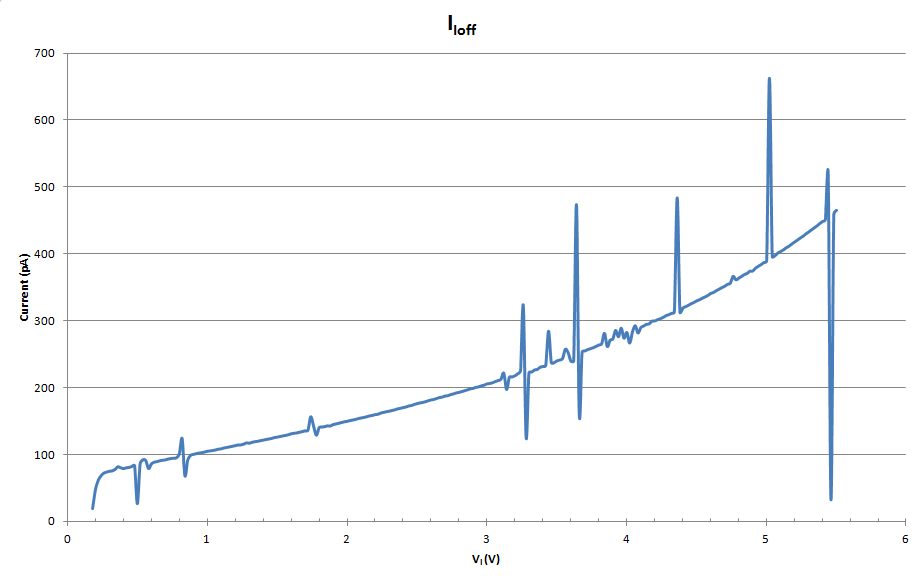

I apologize for the delayed response. This spec was not characterized, therefore I cannot supply a max leakage current for off leakage current. But what I can do is supply typical values at room temp.
I will measure these values and get back to you with the results.

So we will be able to connect the TCA9539 to an active bus directly, even
if the device not powered occasionally.
