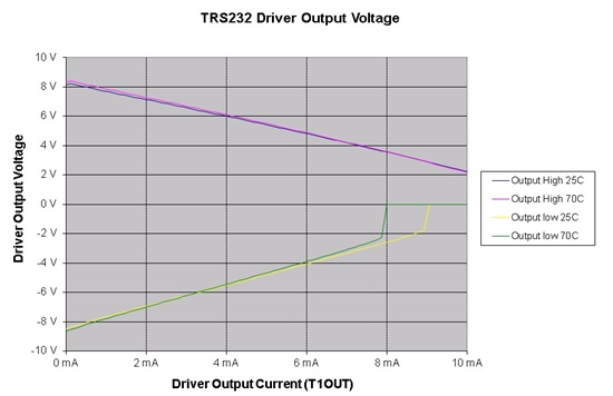

You are correct the current will nearly double. There are differences in driver performance based on the RS232 driver used. All drivers can tolerate 3k which is the minimum specification in the MAX3232 data sheet. The expected range for RIN on MAX3232 is 5k +/-20%. So the load potentially could be as low as 2k with two receivers. This is why I said the voltage may be lower.
Connecting the two receivers will work except for cases with highest speed, longest cables, and noisiest environments.
Here are two driver output curves.

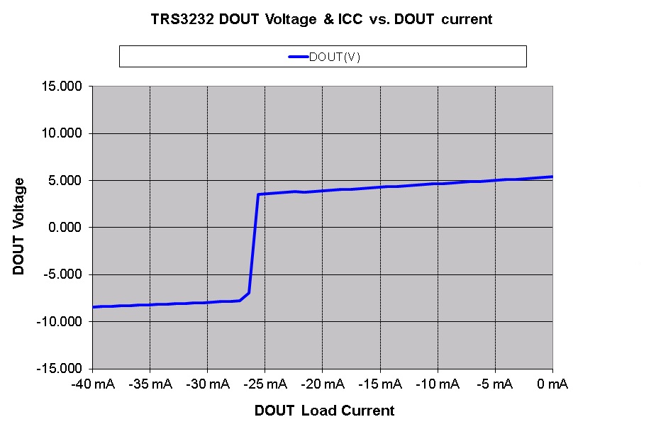

Hi again Ron,
Do you have similar curves like the one you posted befor but for driver MAX3232?
Nuba,
MAX3232 is same as TRS3232 in every way except for first three letters in device name.
Therefore the TRS3232 curves apply to MAX3232.
