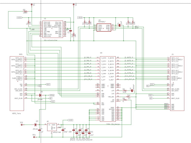

  • Nassner:
    We have completed the build with the DS34RT5110. The unit works fine except an intermittent audio output.
    No real pattern, just random cut out. There is now effect with the video. The video is perfect.
    I now the audio is put up on one of the TMDS lanes so I not sure why the audio would cut out. I tried this with all eq settings and multiple lengths.
    Thank you again
  • Hi Jeffrey,
    Could you please send us a block diagram of your system or the HDMI receiver? It is odd that video is fine but you are getting audio cut outs.
    Regards,,nasser
  • Nasser:
    Attached is the schematic we used. I have done more work on this since I wrote and find this happens pretty much all the time on any length of cable. I also used HDMI cable that had better performance but still the audio will drop out leaving the picture perfectly in tact.
    I have increase the filtering on the power supply also, although the amount of noise on that bus is less than 5mil pp.
    Thank you for your help on this.
    Jeff

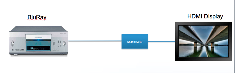

  • Hi Jeff,
    Thanks for sending us the schematic.
    Could you please send us a block diagram of your overall test setup? For example what instrument is generating the video and audio. Also, what instrument is decoding the vido and audio. It will help us to understand the overall test setup you are using.
    Regards,,nasser
  • OH,  in final test it is just a BluRay player and an HDMI Display.
    Block attached.
