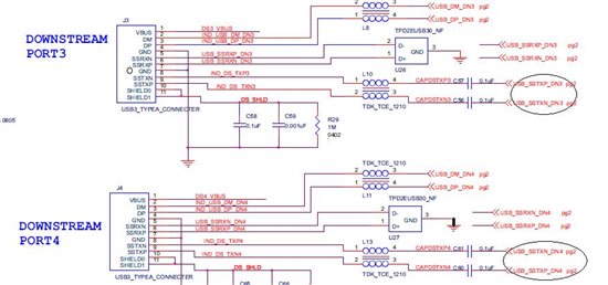

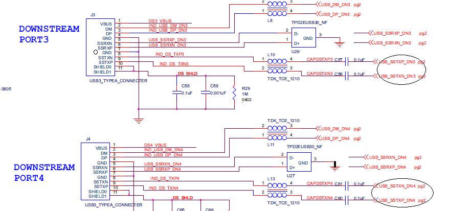

Dear sir:
    Please find below from TUSB7320/TUSB7340 EVM User's Guide Schematic:
   Only Port 4 SSTXN/P is negative connect to Negative. Other 1, 2 and 3 is Negative connect to positive. No other place reverse this signal. Is this a problem? thanks.
