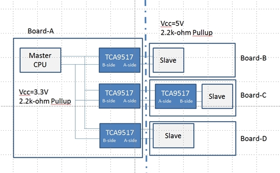

Hi all,
Is ti possible to connect  B-Sides of TCA9517 together in case of below Board-A?
Thanks in advance.
  • Hello Toshi,
    This configuration is not possible as any clock stretching on the 5 V side by one of the slaves will not be seen by the other two and will cause issues.
    This will work if you switch make the A side 3.3 V and the B-side 5 V (keep the 4th TCA9517 on Board-C the same).
