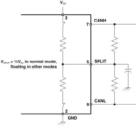

    I have a concern about pins S and VREF. How do I connect these pins to 3.3V MCU?
    Mis-wiring protection is extracted from DeviceNet spec as below pictures
  • Mis-wiring protection circuit is attached in word file.1541.mis-wiring protection circuit.docx
  • Hi Loc,
    The VREF pin is a VCC/2 voltage reference made for common mode bus stabilization. It is used in what is known as "Split Termination". Please see picture below.
    The S pin for placing the transceiver in either silent mode or normal mode will just need to be connected to a standard GPIO pin. It will need to be pulled high (VIN > 2.0 volts) for silent mode and low (VIN < 0.8 volts) for normal mode.
    In terms of the mis-wiring concern, since the SN65HVD252 is not able to withstand negative voltages greater than 0.3 volts, it looks like you will need to implement the protection that the DeviceNet Spec is calling out.
    John
