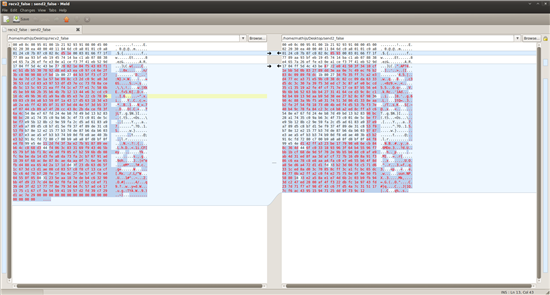

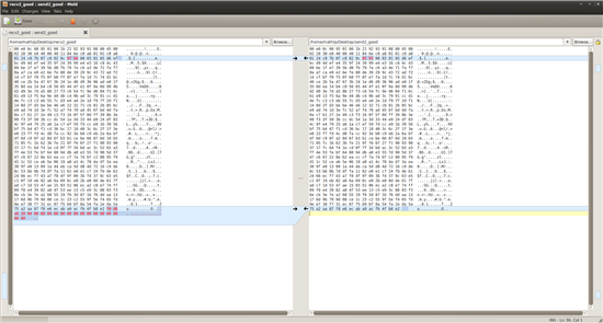

I've tried a 100mbit full duplex, half duplex and a 10 mbit half duplex connection, but all speeds fail in 1 % of the packets. On normal conditions, there are 562 bytes captured by the MAC, but when the faulty packets are received, sometimes 563 or 564 bytes are read.
When I memory dump the received packets, and compare them with the send packets something strange shows. Please keep in mind that in the memory dump of the received packets, I print 16 extra bytes, just to show any gibberish when available.
A good packet looks like this (received on the left, send on the right)
A faulty packet looks like this (received on the left, send on the right)

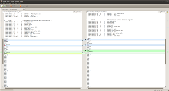

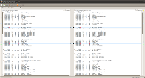

    I've dumped the registers as you suggested and reviewed the differences between the default after reset and the state after a successful transfer (e.g. ping test). Those differences are the same compared to a default and unsuccessful transfer (failed TFTP block).
    Here's the complete dump after a (un)successful transfer:

    The difference in the PAGESEL register is because of the iteration over all the pages.
    Mathijs

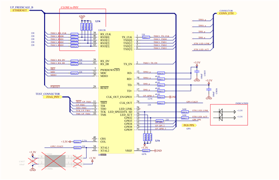

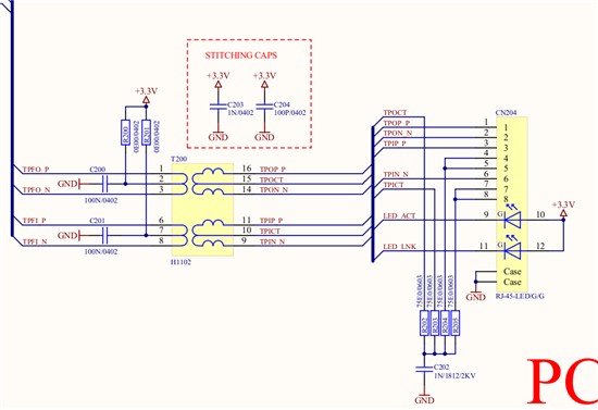

  • Hi Patrick,
    I got the clearance to post a part of the schematics (PHY and magnetics).
    Please keep in mind that we made the following modifications according to the schematics!
    Pin nr Pin Name Changed To (volt) Resistor (Ohm)
    40 CRS pull up 3.3 2K21
    28 LED LINK pull up 3.3 2K21
    1 TX CLK pull down 0.0(gnd) 4K7
    30 MDIO pull up 3.3 4K7
    31 MDC pull up 3.3 4K7
    Mathijs
  • Mathijs,
    I do not see any issues with the base page register contents.  It does not appear that you have made any changes to pages 0x1 - 0x6.  The schematic also looks correct.
    Could you take some measurements of your design to verify some basic parameters?
    1. With the device powered up, please measure the voltage on the VREF resistor.  It should nominally measure 1.2V.
    2. With the device powered down, please measure the resistance across the 4.87 kOhm VREF resistor.
    3. With the device powered down, please measure the resistances of the 49.9 Ohm termination resistors on the TD+/- and RD+/- traces.
    Patrick
