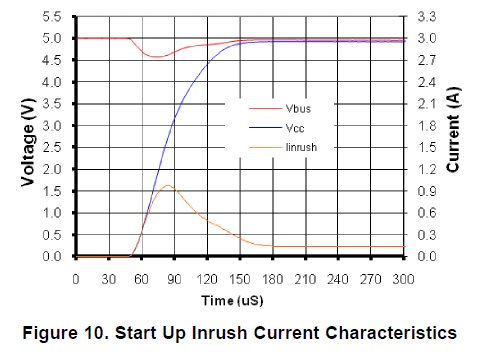

Does this part support soft-start? If so, what is the slew rate?
The TPD4S014 part has a delayed turn-on at 16ms. However, I’m interested in soft-start which would slowly turn on the integral FET and limit the input in-rush current.
The TPD4S214 part has both delayed turn-on and soft-start.
Can you please let me know about the slew rate and soft start on the TPD4S014?

    The TPD4Sx14 are similar devices, but have some basic differences.  The soft-start feature is included only in the TPD4S214.  The 16ms delay of the '014 allows the VBUS to stabilize before closing the switch, and acts as a de-glitch to prevent unnecessary switching. Note that a big difference is that the '014 does not have current-sensing, no OCP and requires an external device for this purpose, if so needed.  The '214 on the other hand, has OCP and current sensing built-in, so your requirement for In-rush current protection is available only in the '214.
    Note also the '214 is USB3.0 and USB2.0 compatible, the '014 only USB2.0.

  • some additional information on on-rush of the TPD4S014, insight by Ed Walker:
    You can get a good idea of the slew rates and inrush by looking at Figure 10 page 8 in the datasheet.  USB allows a 10uF cap on Vbus as shown in Fig 1 of the datasheet, and the Inrush as shown in this graph (Fig 10):
