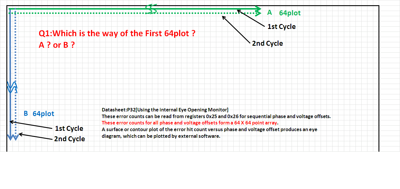

Please let me confirm some questions about DS110DF410.
My Custmer want to try viewing an eye diagram by external software.
Regarding to the Datasheet of DS110DF410 on page P32, Method: [Using the internal Eye Opening Monitor]
"A surface or contour plot of the error hit count versus phase and voltage offset produces an eye diagram, which can be plotted by external software."
I understood that by referring to the data stored in the 0x26 and 0x25, to be able to draw the eye diagram.
The error count data that they have read, Where start from any position in the 64 * 64?
Please refer to the Appendix.
Best regards
Sugiyama
  • Sugiyama-San,
    I apologize for the delay.
    It is B.
    I am working on putting together a procedure for measuring EOM. I am hoping to have this posted in 1-2 days.
    Regards,,nasser
  • Hi nasser-san
    Thank you for the Answer .
    And , I'm looking for post procedure manual of EOM.
    Best regards
    Sugiyama
