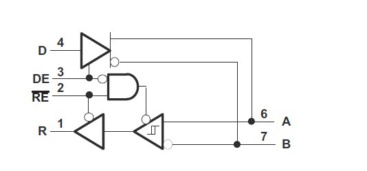

   According to the internal circuit of SN75HVD3082, when driver is enabled, the receive line should be high impedance.  But I see that it is going low.  Why is this happening.

  • Hi John,
                  I have tied DE and /RE pins together.  When I enable the driver by driving DE high, according to the internal circuit diagram, R should be high impedance, isn't it.  This figure I have extracted from the datasheet.  But I am seeing that R is going low when DE-/RE is driven high.
  • Hi Davis,
    You are correct, if the /RE pin is tied high the R output should be disabled and it should be in a high impedance state. Do you have a schematic that you could share showing your set-up?

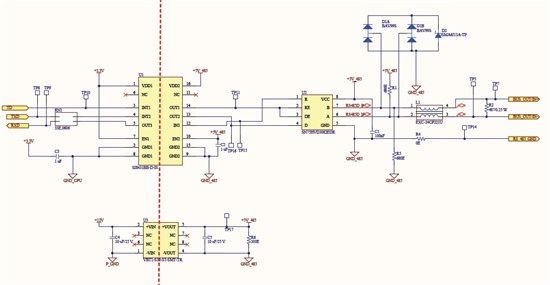

  • Hi John,
                    The schematics is attached above.

  • Hi Davis,
    I am no expert at the Si8431 device, but I think the reason you are seeing the low on the OUT3 pin is because of the way the device is designed. On page 20 of the datasheet there is the following table:
    I feel like there is one line in the table that is missing (with "X", "H", "P", "P"). But, from looking at the table it looks like if the input is floating "X", the EN pin is high, and both supplies are active, then the Output will be low. Can you check if the R pin is actually driven low? Are you just assuming the pin is low because the OUT3 is low?
    Let me know if you think I am misunderstanding the table.
    John
