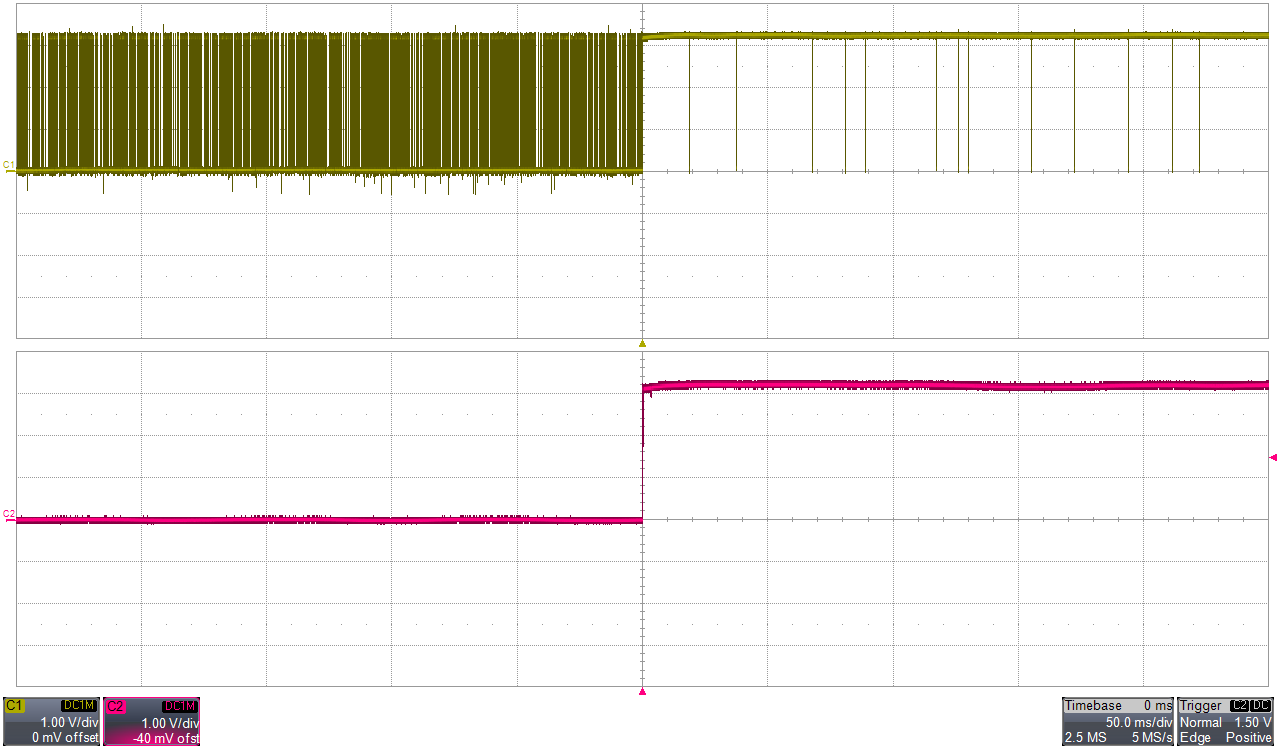

  • I followed the steps on page 34, but there is still no uplink on the GPIO[0] pin (PASS LED lit).
    Before the last step on page 34 is done (Return the control channel driver of the DES...) there is a reaction on the GPIO[0] pin. The following screenshot shows the reaction.
    The bottom Signal is the input GPIO[0] pin at the DES.
    The upper Signal represents the answer of the SER at GPIO[0] pin.
    Normally the upper Signal should look like the bottom Signal.
    The PASS LED is still lit up at this moment.
  • Hi Viktor,
    After following the remote wake up procedure on page 34, does the LOCK (LED2) light up? PASS LED is always lit and only valid under BIST modes.

  • Hi Dac Tran,
    the LOCK LED doesn't light up.
  • Hi Viktor,
    The LOCK needs to be on in order for the GPIOs to function. Can you get any LOCK status when you configure serdes in display mode (1621 MS=H and 1622 MS=L)?

  •  Hi Dac Tran,
    the Problem has been solved. I haven't said that I also use a RJ45 to SMA Adapter Board (DS91C176EVK).
    The unidirectional communication worked without problems. But the bidirektional channel has been blocked by the additional resistor between the differential pair (R8).
    Nevertheless thank you for your efforts.
