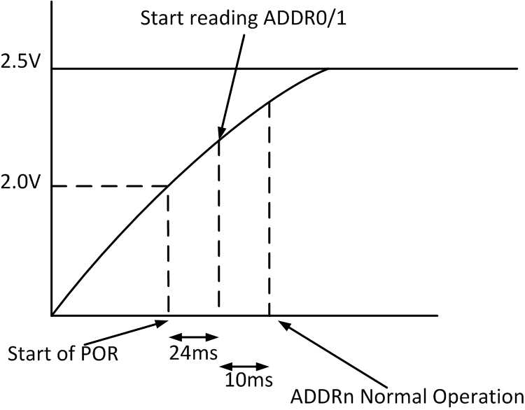

  • Kawai-San,
    Please below note the reset timing
    Regards,,nasser
  • Nasser-san,
    Thank you for the information. I understood this information is for device power up at VCC increase.
    How about the wait time for register reset using the SMBus command ?

  • Kawai-San,
    Once they can do SMBUS access, this means the reset is done. After they issue reset, they can do SMBUS access to read for example chip ID and revision(register 0x01).  Once they are able to read the revision correctly then they know the reset is done.
    Regards,,nasser
