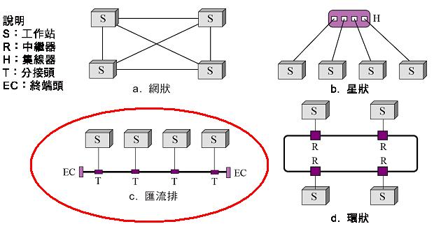

DP83848 can use Bus Network topology (C)? Please provide reference designs. Thanks~
Eric Lo
Eric Lo
The DP83848 supports 10Base-T and 100Base-TX communications. These standards support communication via point to point or switched topologies, similar to the topology shown in figure B.
