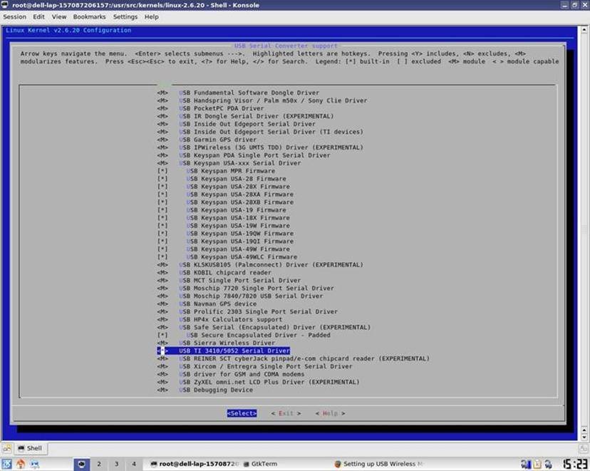

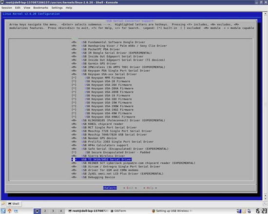

                     In the case that it’s not enable you will require to recompile the kernel and include the 3410 support in it as part of the kernel. The driver should be added in the menuconfig of the kernel under
     Device Drivers -> USB support -> USB Serial Converter support-> Select the <*>USB Serial Converter support to be compiled as part of the kernel, and then add the <*>USB TI 3410/5052 Serial driver as part of the kernel too.
                     Please take a look to the next screenshot:
                    Once you recompile the kernel and you are able to boot with the new kernel version you need to create a rule file as follows:
