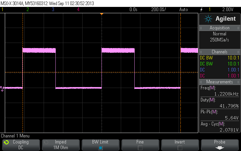

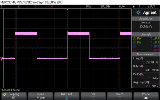

The inputs to Vin+ and Vin- are two PWM outputs from the PIC in differential signal form. eg pwmA: 0~5V, pwmB:0V. The idea is to interchange between which channel is active in order to create both negative and positive PWM output. Vcc1 and GND1 are 5V 0V respectively. Vcc2 is say, 24V relative to GND2 (i.e. Vee-l, Vee-p), and I just set up the circuit from fig.62 of the data sheet.

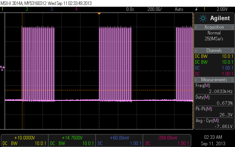

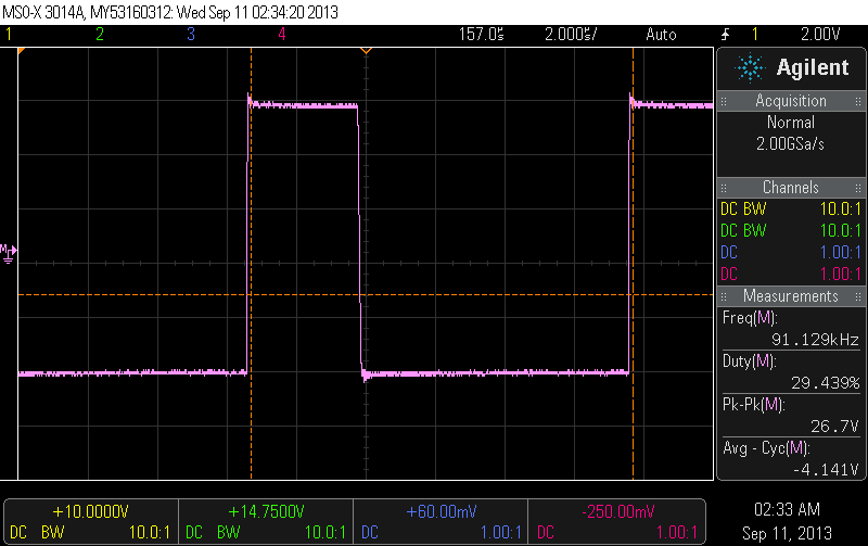

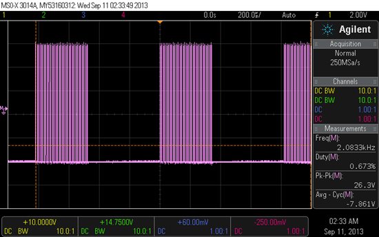

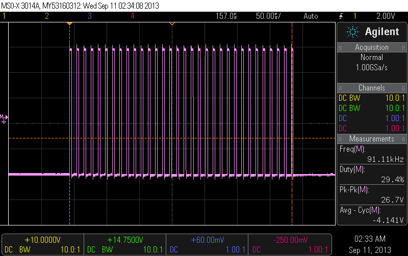

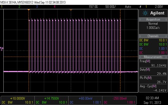

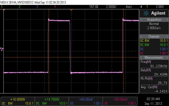

Firstly, I'm observing on my oscilloscope, that the ouput waveform is not the input with amplification. In fact the output seems to be modulated by a chopping frequency of a about 92KHz. The input PWM has 42% duty at 1.2KHz, and ony on very large time scales does the oscilloscope show this. Where does the chopping frequency originate from? The datasheet makes no mention of this.
Secondly, the average value on the output is nowhere near the intended value. In fact, despite having the voltage levels at (relatively) expected levels, the average value shown by the oscilloscope is the negtive ouput rail (-12V relative to Ve).

    These are the outputs I'm viewing on my oscilloscope(agilent MSOX3014A)
     http://www.home.agilent.com/en/pd-1947946-pn-MSOX3014A/oscilloscope-100-mhz-4-analog-plus-16-digital-channels?&cc=GR&lc=eng)
    Input signal:
    Output(Vout(diff) = Vout - Ve, on ISO5500)  in decreasing time scales(zooming in):
    Vout is clearly modulated by the 90KHz and the mean value(which is exactly what I want to control as a function of Duty cycle) are clearly not the desired.

    That being said, I'm not sure about the behavior you are witnessing. Do you have Vin- at 0V and the PWM signal (shown) at Vin+? Can you check the FAULT pin and see if it is doing anything?
    Jason
  • The thing is even one big square wave is fine as long as it is the same frequency and  duty as the input. In this case i can just have 50% duty as zero mean i.e zero motor current, below 50% can be CW and above can be CCW. my main problem is the distorted output. the fault pin is pulled-up to Vcc1(+5V) by a 3.3KOhm resistor, and I found that the output appears only when RESET is at GND1 directly. Also it does not output -10/+10 because if (Vcc2 - Ve) is below 12.3V according to the datasheet, then UVLO function disables the output(is held low). This is the reason I increased Vcc2 to 24V and connected Ve to +12V(as reference for Vo). Is there any way to bypass this so I can get it to work at -10/+10V? I think the chopper is the cause for the wrong mean value, but I don't understand why it happens in the first place.
