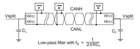

according to the ISO1050 datasheet, in order to improve the electromagnetic emission behavior of network, split terminal resistor is needed. my question is: can you recommend Csplit between two 62ohm resistor?

    In terms of the split node capacitor I have seen anywhere between 4.7nF and 100nF used. The corner frequency is equal to:
    So depending on where you want the cutoff frequency of the filter to be, you could vary the value of CL.
    John

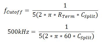

  • Hi Tian,
    I would use the factor of 5 in the equation. To help explain, let's say you are trying to operate your network at 1 MBPS( which is equal to 500kHz). The equation I am recommending that you use is:

  • HI John:
    i got another question for your eqution...
    in my opionion the eqution is :
    do i misunderstanding?

    I have always used 60Ω for my calculations. The reason is there is normally a somewhat significant bus between the two terminations that decouples the two filters. This bus will have series inductance, resistance, and parallel capacitance that will be sitting between the two terminations. Also the noise on each line will only see one half of the 120Ω resistance.
    Also I want to point out that I made a mistake in my statement above. This filter only filters the common mode noise, and therefore it will no filter the CAN differential signal . I apologize for the mistake. I am going to update the response.

  • John :
     Thanks for your answeres...
    i am confused, if the eqution on how to calculate CAN bus's filter is correct, why is Csplit is 4.7nF to 100nF is existed?
    as my calculation:
    so Csplit is a fixed value.why? i am so confused now....i think  i 've made a  misunderstanding.

  • Hi Tian,
    Sorry that this has been confusing. The capacitor value does not have to be fixed. I have seen in range from 4.7nF all the way up to 100nF. This results in the common mode corner frequency ranging from 26.5kHz to 564.4kHz.
    The fixed part of the equation should be the resistor. This is supposed to match the differential-mode characteristic impedance of the cable. This is usually always 120Ω, so people just make the split termination resistors 60Ω each.
    The factor of five is pushing out the filter corner frequency a half a decade. So realistically what it is doing to the equation is making the capacitor value 5 times larger since the resistor value is staying constant. You do not have to use this factor of five if you do not want to. It is a common mode filter and not a differential filter.
    Hope this clears up some of the confusion, I think the applications section could have been written a little clearer.
