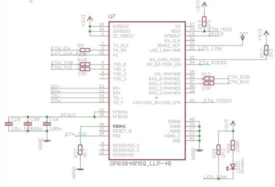

I've bought an Ethernet starter kit using DP83848c with PIC32 (in RMII mode) with the provided code and it works very well.
Then i've made my own PCB but using DP83848m with PIC32 (in RMII mode).
It's detected in the network, and i could load the html page twice.
It is still detected on the network but i can't load the pages any more.  So i no idea of what could be happening.
Any idea please ?
Here are some DC points i've check :

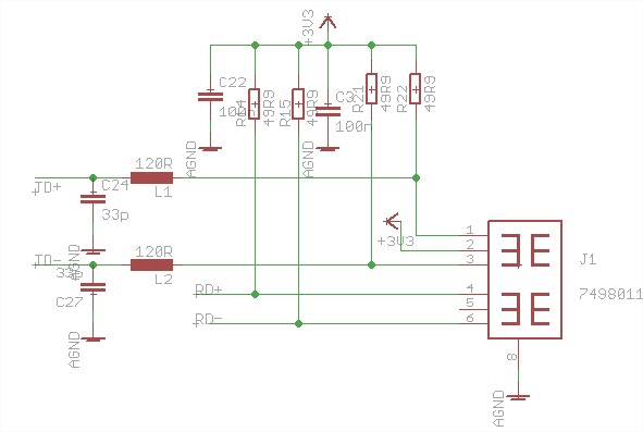

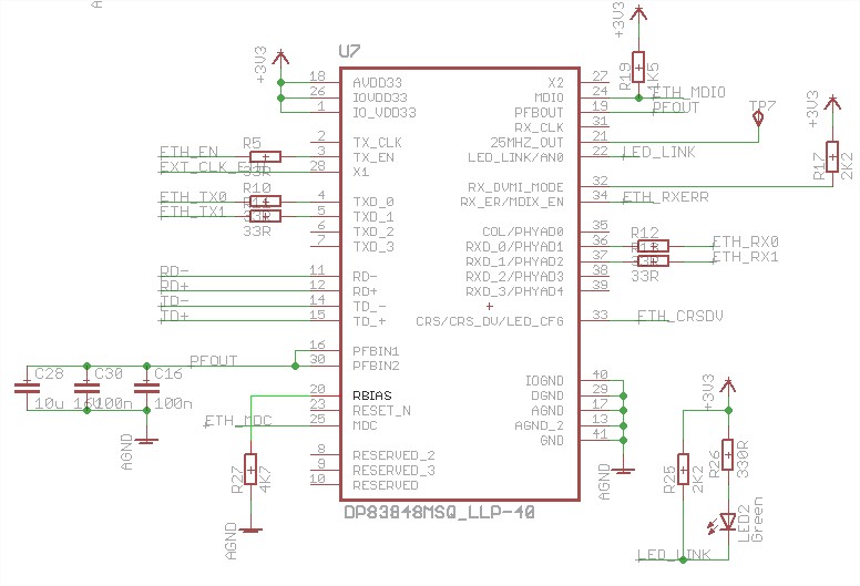

    A few comments on the schematic:
    1. L1 and L2 are not recommended.  TD+/- should connect directly to the transformer.
    2. Both center taps for the transformer (pins 2 and 5) should connect to 3.3.V.
    3. The RBIAS resistor should be 4.87 kOhms.
    Regarding the value on the RX_DV pin, you will need to measure it when the RESET_N pin is asserted in order to see the strap value pulled to the expected voltage.
    Do you have the ability to read the registers via MDC/MDIO?
    Patrick

    thanks for replying !
    1. change done
    2. change done
    3. change done
    Now the hardware looks to be exactly the same.  What could i miss ?
    RESET_N is not used and left unconnected  (like in starter kit).
    I can't read MDC/MDIO, my analyser is to slow.
    I'm running the code in debug mode to see difference between my card and starter kit.
    He never go there ;(
