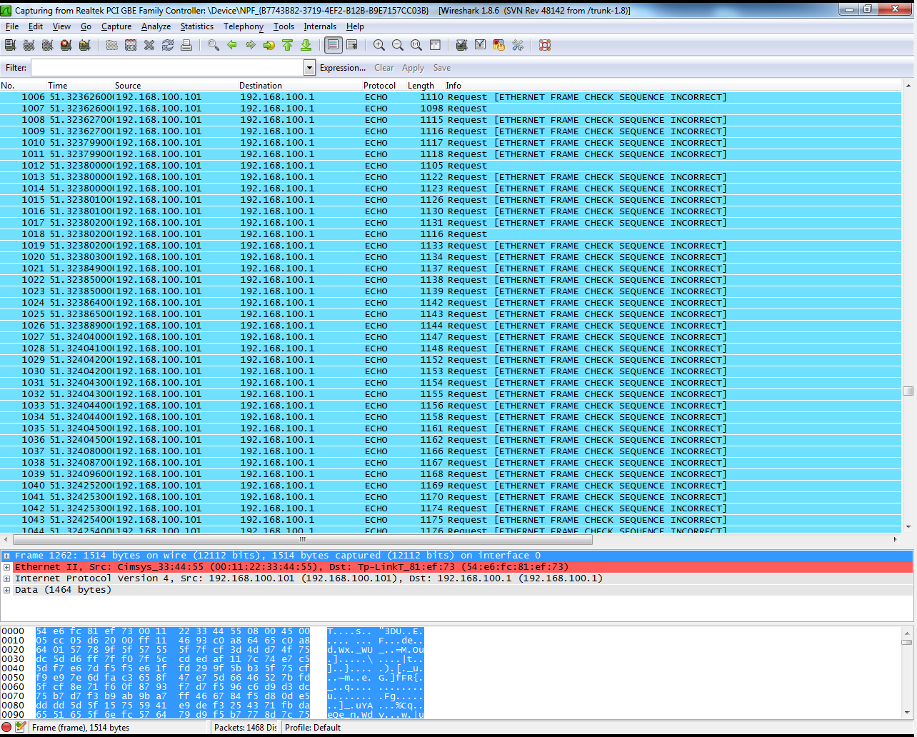

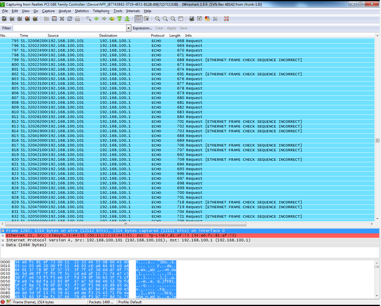

 we use the DP83865 on our custom embedded board and observe strange Frame Check Sequence Errors for long packets (>650 bytes). The error rate increases with the package size and packets over ~1200 bytes are completely affected (screenshots appended). We are not sure if our circuit design is incorrect and cause the problems, but the link is stable and small packets are transmitted without problems. It would be nice if someone can help us to identify/solve this problem.
