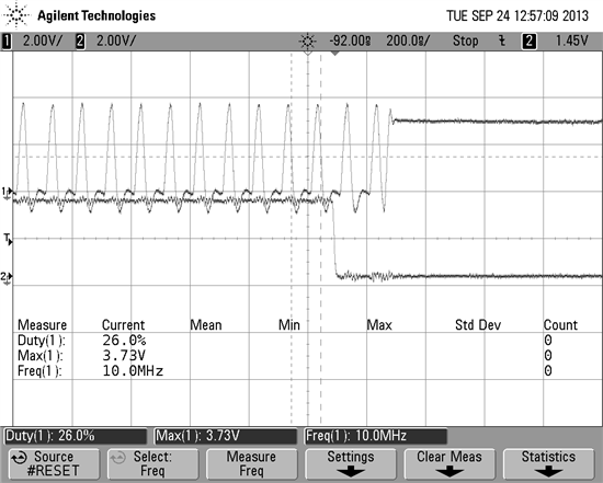

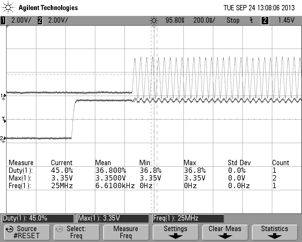

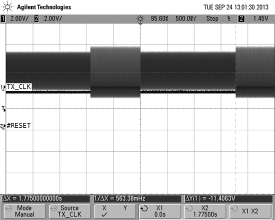

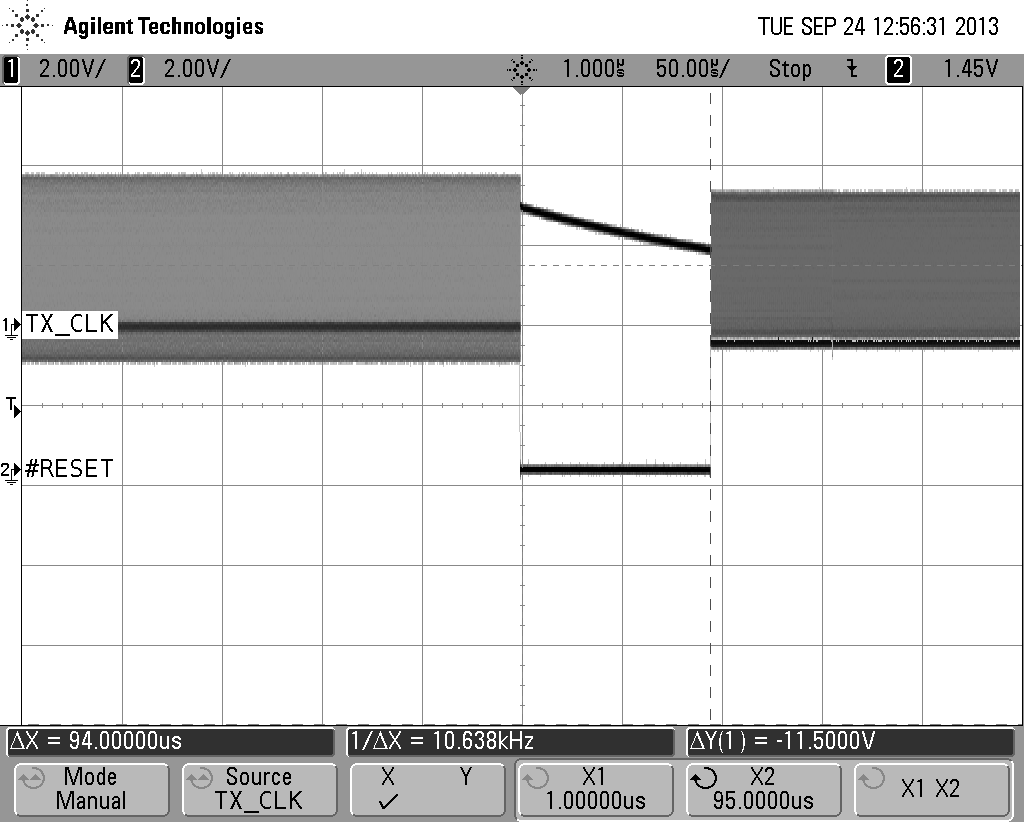

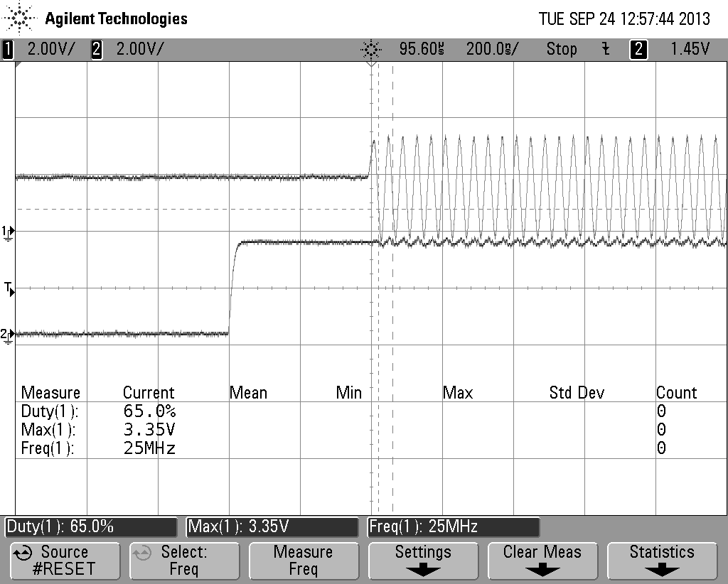

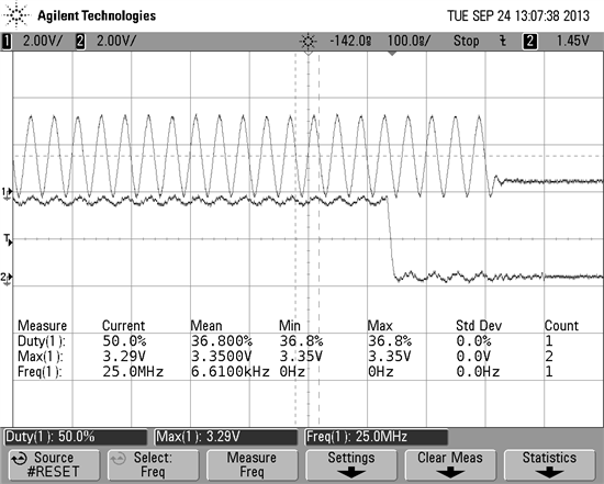

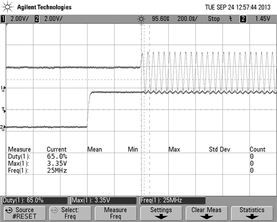

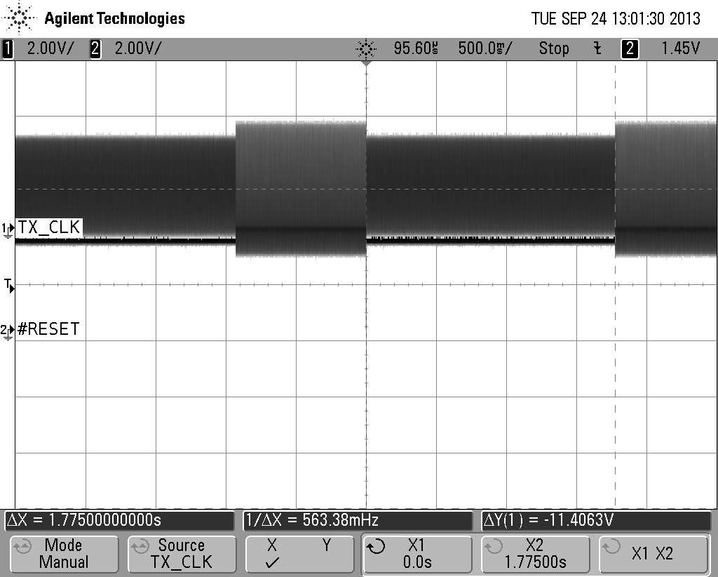

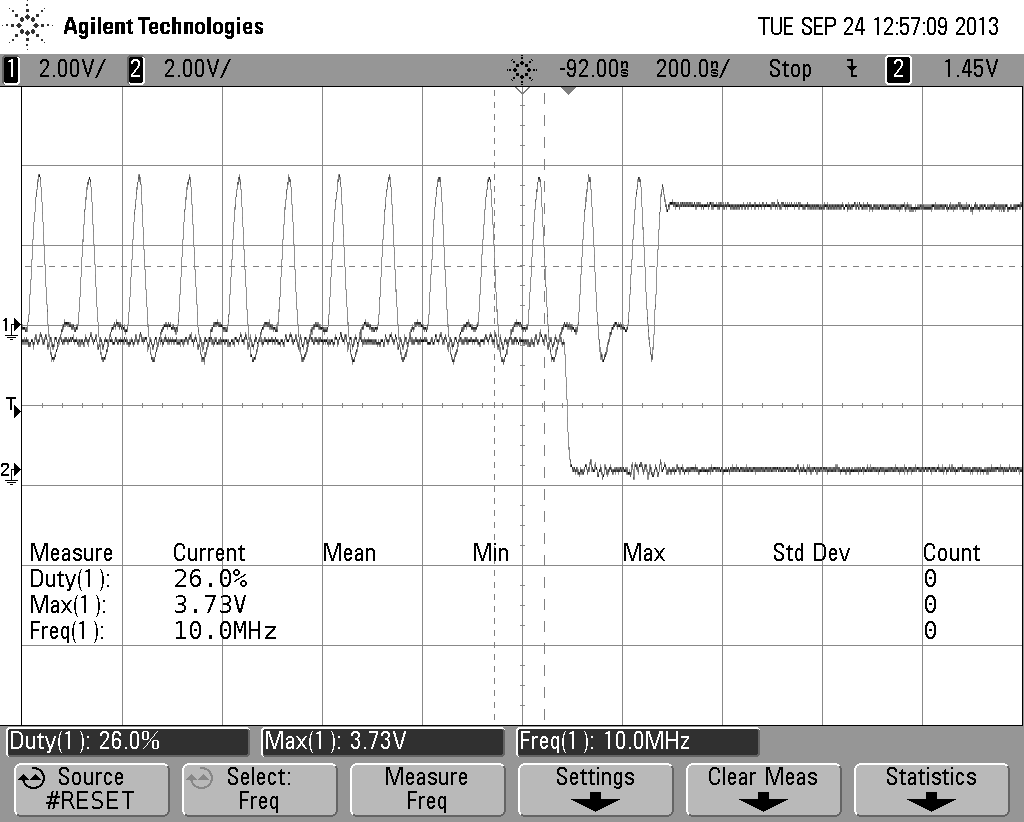

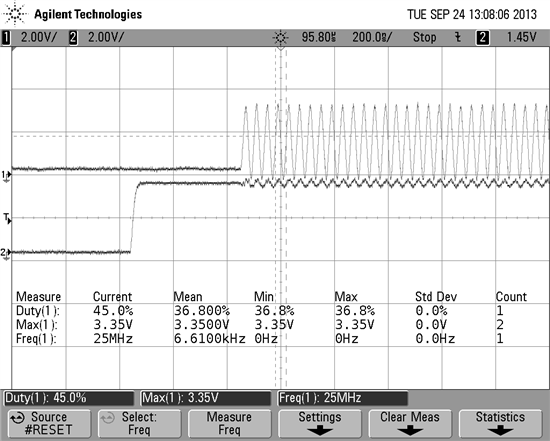

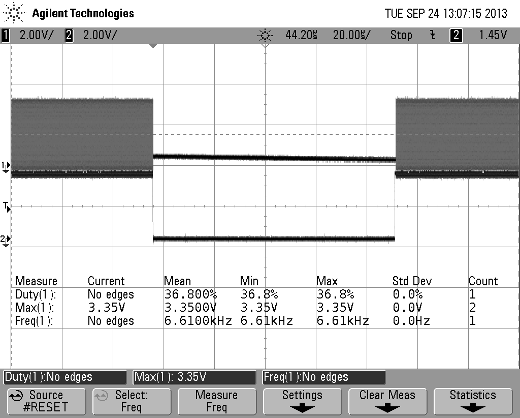

        I have used oscillograph to capture some graphs.
        Test case 1 : Set the CPU always in reset mode and connected the DP83848I to PC. PC's net interface card is set to "Auto" mode.
         The TX_CLK baud rate before reset and after reset is different. Before reset, the baud rate is 10M, after reset, the baud is 25M.
        The TX_CLK baud rate is changed from 25M to 10M after reset in 1.7 second.
         Test Case 2: Do not connect the DP83848I to PC the TX_CLK baud rate is always 25M

        But why the TX_CLK frequency may change from 25MHz to 10MHz in 1.7 second still puzzle me.
