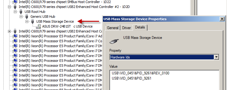

  • I have Flash Burner 2.9.0.0 downloaded last week.
    I attached a picture of the Device Manger. The view by connections only show a USB Mass Storage Device.
    Our SATA devce is a DVD RW.
    I tried XP and Win7 on 2 computers.
    I have restarted several times after SPI programming.
  • Don,
    I see what the problem is now. The version of the FlashBurner you are using (and the one that is available at the website) doesn't recognize ATAPI devices (Optical drives) so that is why the drive instance is not showing on the Flash Burner.
