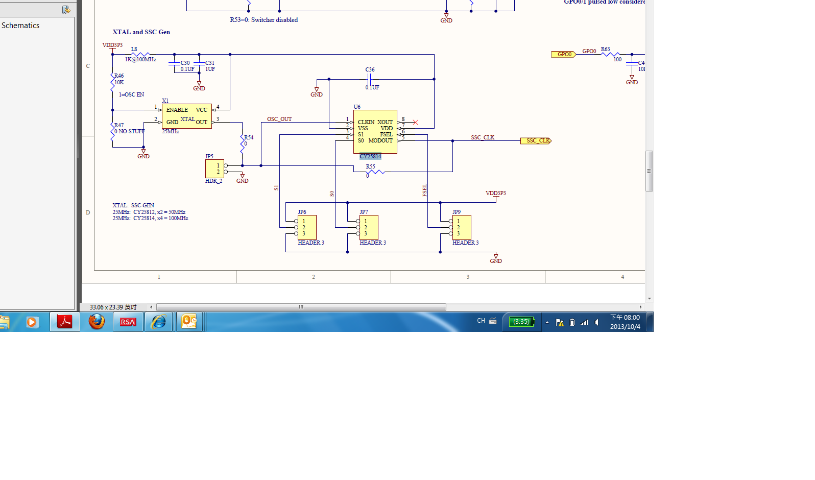

May we check what is DS90US913 EVB U6(CY25814) IC function?
Is just for test or special request?
                                                                        Bogey
  • Hi Bogey,
    On the DS90UB913 EVM, U6 (CY25814) is an option to enable spread spectrum clocking (SSC) in the external oscillator mode. For EVM, U6 is not populated and oscillator mode is disabled by default.
