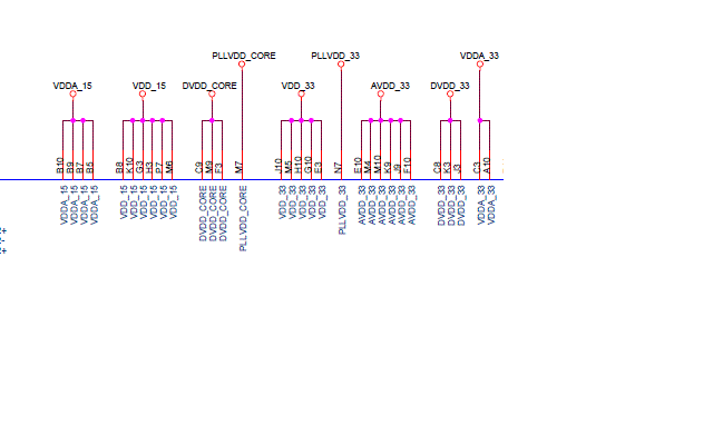

Ask one question. Do we have XIO2213B reference schematics as EVM ? Thanks.

Add more, the reference schematics of XIO2213B will be 2 port for 1394b and one port for 1394a. Thanks.

Can I also know what is the difference on schematics if one port is for 1394a, others is for 1394b?
Hello Patrick,
Terminals DS0, DS1 and DS2 determines if the port is going to be 1394a or 1394b, also I recommend to use a port termination network for a billingual port (see attachment), in this way you can connect both 1394a and 1394b with no further changes.

Can I know have any routing or layout guide to customer ? And how to measurement 1394 to verify performance due to customer has no such experience for it. If has some doc can be shared will be better. Thank you.
Do we have XIO2213B EVM layout brd file that can provide to customer for reference? What is the differential impedance of signal trace for XIO2213 ? Look forward to receive your help. Thanks
Hello Patrick,
File attached, the differential impedance must be 100ohm, you can find this data and more on the Implementation Guide available at ti.com
