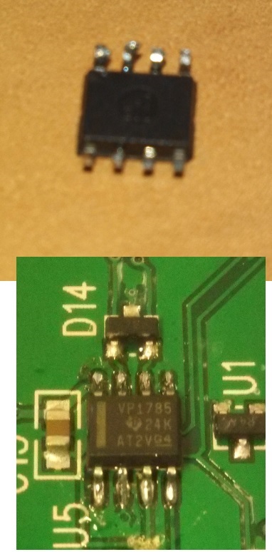

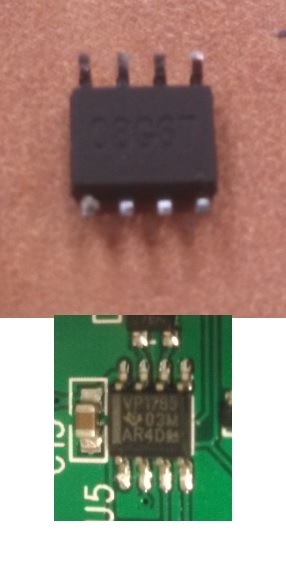

I have an issue with the Rx line sticking low( stays low for several seconds or until another it gets another receive message ) during an open or idle bus. I have two lots and it only happens on one of the lots.
The working chips are
Date : 24k
LTC: AT2V
The chips that do not work are
Date: 03M
LTC: AR4D
Was there as issue with this lot?
