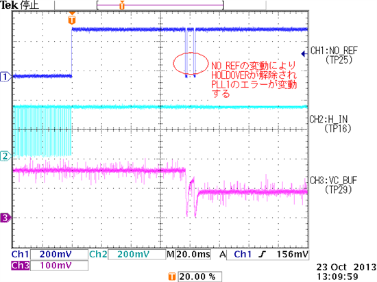

The following situations have occurred here using SD1983EVK.
HOLDOVER is canceled by change of NO_REF and the error of PLL1 is changed.
A photograph is a waveform at that time.
For what kind of reason does such a phenomenon occur?
