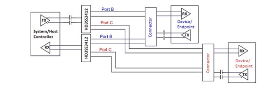

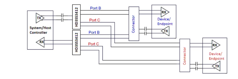

  • Hello Kawai,
    Yes, the switch supports AC coupled signals.
    In order to avoid what you are calling as "voltage range under 0V" the AC coupling capacitors should be placed only on one side of the switch, in this way the other side of the link will provide a bias voltage to the switch.
    For example, in the below picture, the switch on the top is biased by the endpoint device and the switch on the bottom is biased by the host controller.
    Regards.

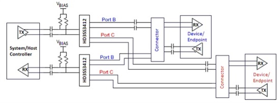

    I don't have expertise with the DS80P device, but if it is biasing the differential lines, then it should be OK.
    In general, when you require AC coupling capacitors on both sides of the 3412, you have to provide an external bias voltage, this voltage should be less than 2V.
    Regards.
  • Elias-san,
    I found DS80PCI800 had bias voltage around 1.6V on my evaluation board. So I guess we don't need external bias voltage.
    By the way, if external bias is needed what is your recommendation for the pull up resistor ?
    Kawai
    You can use 10K resistor.
