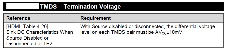

Our customer will use TMDS361B in their application. I have question about HDMI compliance testing.
In the datasheet it says,
"For HDMI compliance testing (TMDS termination-voltage test), the clock-detect feature should be disabled. In this mode, the terminations on the TMDS input data lines are always connected when the port is selected."
If you disable the clock-detect feature, it seems the compliance testing is meaningless. Is this acceptable in the compiance testing ?
Our customer is worrying that they may not be able to pass the test.
Please give us TI opinion.

    The clock-detect should be disabled only for the "TMDS-termination voltage test", this is just one of the several compliance test steps.
    I don't understand why they say that the compliance test is meaningless when you disable the clock detect feature.
    Can you elaborate more/

    Cusotmer thinks that compliance test should be tested in the normal operating condition, which means that disabling clock detect function would not be the normal operating condition.
    They doubt that testing in unusual condition could pass the compliance test.
    Is it permitted to turn off the clock-detect function in the "TMDS-termination voltage test", in the compliance test ?

    I've been looking into this and I have the answer:
    The HDMI Compliance test specifies for "TMDS Termination Voltage" test that the source must be disconnected from the sink in order to measure the voltage at the TMDS lines.
    The clock-detect feature is a special feature of our device, it has nothing to do with the HDMI spec. If the clock-detect feature is not disable, then when the Source is disconnected to perform the test the TMDS361B will enter in a power saving mode and the test will not be possible.
