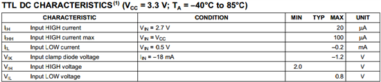

I'd like to ask about SN65LVELT22.
I found "Drop in Compatible to MC100LVELT22" in SN65LVELT22 datasheet.
It seems MC100LVELT22 can input LVCMOS, so I think SN65LVELT22 can input LVCMOS too.
Is my understanding is correct?

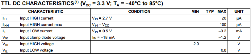

  • Yes, SN65LVELT22 can be used at LVCMOS input.
    It depends on the voltage. We compare LVTTL and LVCOMS as below, LVTTL voltage range is larger than LVCMOS, so LVCMOS can be used in LVTTL input component, but LVTTL maybe can’t be used in LVCMOS input component.
    LVTTL 3.3V voltage:         VOH>=2.4V;VOL<=0.4V;VIH>=2V;VIL<=0.8V
    LVCMOS 3.3V voltage:   VOH>=3.2V;VOL<=0.1V;VIH>=2.0V;VIL<=0.7V
    The SN65LVELT22 input voltage and current is as below, it is ok.
