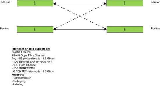

Is there are Mux / Buffer / Repeater from TI (SN65 || DS12/14) that can support data rates from 1G - 11.3G?
Our customer is looking for such a solution. if the solution will have CDR incorporated it will be better.

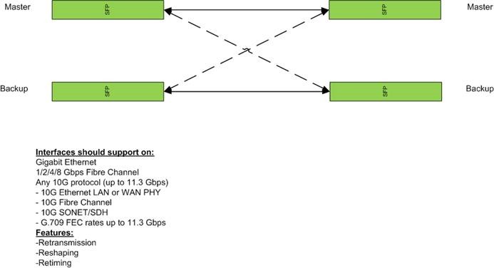

Hi Ran,
Please take a look at DS125BR401, DS125DF410 and DS125MB203 devices. These are either buffers, buffers with retimiers and buffer/mux.
Could you please tell us about the application or a block diagram then perhaps we can comment further and suggest the appropriate solution.

Hi Nasser,
I just wanted to make sure that these parts can support 1GHz of data.
As there is no Gain to BW plot I can not be sure.
Ran
Hi Ran,
These parts can support 1 GHz or even lower. For lower data rates, the AC coupling capacitor value will need to be increased.
