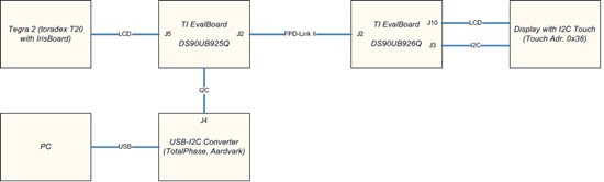

    My Testsysten:
    With this system and register setting, I couldn't measure a signal at the SCL Pin at the 926 deserializer Board.

  • Hi Dac,
    Just to be sure: if all works fine it should be possible to measure a I2C Clk at the pin 3 of the 926, and it is possible to have a standard I2C communication from / to a touch controller witch is connected at the 926 (like in the picture in some post's earlier.
    At the moment it doesn't work, but I haden't tested your last answer.

    I have developed our own system with the DS90UB925 / 926 (like in the sketch above).
    All things works fine. On the I2C bus I have the touch controller, now I want connect a second I2C device to the the I2C bus. Is it possible to connect more than one I2C device to the DS90UB926? If yes, which are the values for the configuration?
