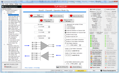

    I caputred the Screen of  10022/81 Evaluation Software.
    Fig1 : Operation Mode Cfg : RxMode=3 Ln Mode, TxMode=3 Ln Mode.

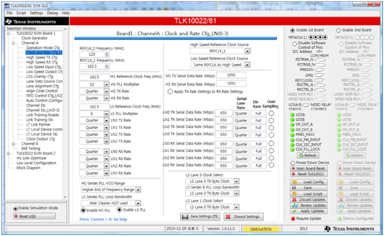

    Fig2 : Clock Rate Cfg : We set frequencies to make HS data rate 1950(65*10*3) and without Error Display (RED Blinking).

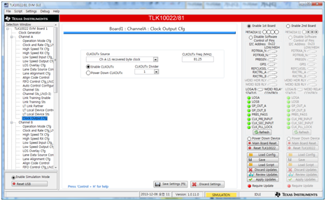

    Fig3 : Clock Out Cfg : If we select HS Recovered Byte Clock, the clok out freq is 97.5 as expeced (97.5=65*3/2  or 97.5= 1950/20)
    Fig4 : Clock Out Cfg : If we select LS Recovered Byte Clock, the clok out freq is 81.25  (81.25=65*10/8  or 1950/24)
    Q1 : Still, we can NOT get 65Mhz. Please let me have your comments. Dylan !!  Anything wrong in the parameter settins?

    Could you change the clock for a try. I use the 130M reference, 15 for HS PLL, 10 for LS PLL, and get the right frequency 65MHz. But the 162.5MHz, 12, 8 doesn't work too.
    Best Regards
    Dylan Yao
  • Hello  Kwangil,
    I tested in the TLK10022 EVM board, and let's talk about the result.
    Both 162.5MHz and 130MHz works, It can recover 65MHz  from LS data side. So, there are some caluation mistakes in the gui simulation mode.
    The configuration is the same as you did except the CLKOUTx divider in your Fig4, we should set it to 4. That is to say, the oringinal LS recovered clock should be 260MHz, and this answer was from IC design guys.

    1.  TX configuration  : 3:1 mode
    2.  TX LS line rate : 650M with 8b10b
    3.  TX High side Reference clock source : REFCLK_1
    4.  TX REFCLK_1 Freqency : 162.5M
    5.  TX HS PLL Multiply : 12
    6.  TX HS Tx Rate : Quarter
    7.  RX LS Rx Rate : Quarter
    8.  LS Reference Clock  Freq : 162.5M
    9.  LS PLL Multiply : 8
    10. LN0,1,2,3 TX Rate :Quarter
    11. LN0,1,2,3 RX Rate :Quarter
    12. RX CDR Freq (Recovered Clock Out of LS) : 65M
    13. GUI Configuration 첨부
    14. TX Register  Settings
        <addr  =    data>
         0x01  =  0x40a2
         0x02  =  0x8318
         0x03  =  0xaa4e
         0x06  =  0x8114
         0x07  =  0xde06
         0x15  =  0x207
        The other Registers : Default Value
