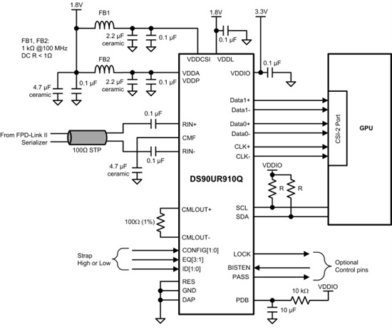

Automotive customer is preparing advanced multi-camera video system,  connected via LVDS in 10/12b standard based on DS90UB913/14Q pair. They need to convert data from LVDS to CSI-2, similar to as shown in note of DS90UR910Q:

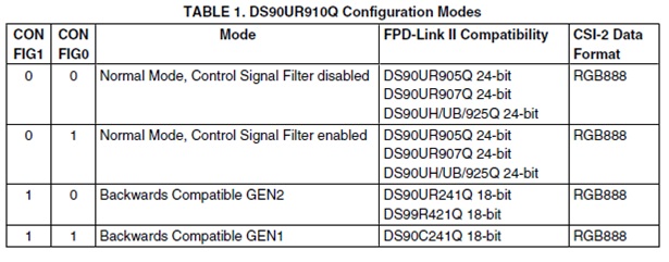

But according to the table below:
- DS90UR910Q is NOT compatible with the mentioned SER/DES pair.

    The DS90UR910Q is NOT directly compatible with DS90UB913/4. In addition, the DS90UR910Q needs to be paired with a FPD-Link II serializer. The serializer (ie 905/907/925) is expecting a dRGB (18- or 24-bit RGB color) input format. This can be implemented with a 3 chip solution such as:
    914 -->YUV/RAW--> FPGA --RGB-->  DS90UR905Q  --FPDLink2-->  DS90UR910  --CSI-2->
    As for alternative solutions, you may consider Toshiba TC358746 MIPI Bridge.
