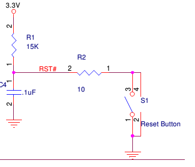

I've some trouble using a TUSB2046B on my board. I'm using the circuit shown in the datasheet of the TUSB2046B, figure 11 (bus-powered hub, ganged-port power management). Actually, I'm working with Windows 7. After connecting the device, window pops up - "unknown device". The device manager indicates an error "code 43". I've already searched the web and there are a lot of problems using usb devices and this error code, i am using tps2460 instead of tps 2041.Is it possible to switch with this 5v power switch Ic? does the circuit work without tps2041?
am attaching my schematic here.please reply
