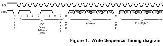

Our customer has a question about the datasheet description of I2C Write Sequence(P20 Fiqure 1).
I think the correct answer is following.
Is this correct that?
$CD ⇒$CC ,Read⇒Write
Kato / Japan disty

Kato-San,
Default device I2C address 0x66. When we are performing write operation, we have to append 0 to 0x66 so we will have 0xCC to initiate a write sequence. Please check the data sheet on the web. In the data sheet on the web we have 0xCC instead of 0xCD as the figure 1.
Regards,,nasser
