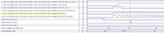

I bring up the TUSB1310A, I can get PCLK and ULPI clk from PHY, but I try to write register 04 for ULPI reset, but PHY do not assert the NXT. Could you help me.

        I cannot see clearly how are you trying to activate the reset. You only have to assert the bit 5 of the Function Control register(04h-06h), and the response on the TUSB1310A will be: After de-asserting the ULPI_DIR, the PHY must re-assert the ULPI_DIR and send an RX  CMD update on the Link Layer Controller. Also please take into account that the Link  Layer Controller must wait for the ULPI_DIR to deassert before using the ULPI bus.

    For this issue, I had resolved it, when TI PHY asserted the nxt,the ULPI_CLk in FPGA which output by DCM  is not stable, the frequency of ULPI_CLK is less than 60M, So I waited until ULPI_CLK is stable, then wrote ULPI reset, I could  read this nxt pulse. And TI PHY work well.
