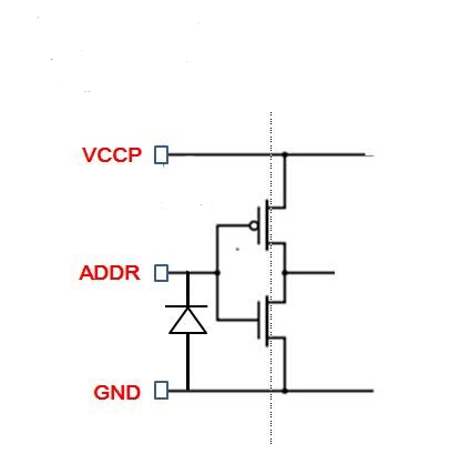

Our customer has a question about ADDR pin configuration.
I consider the following figure.
Is it correct?

Kato-san,
The ADDR input structure is more like this:
This is just an approximation based on your original drawing, not the actual design schematic.
There is no diode to VCCP.

Brian - san ,
Thank you for the answer.
That means we can set VCCP=1.8V and the high-level of VADDR =3.3V?
We need not use levelshift device?
Kato
Kato-san,
In terms of the input structure, there is no diode there so one might assume there would be a large amount of current leaking from VADDR to VCCP.
On the other hand, it is very difficult to tell every leakage path of the device to determine what will happen when VADDR > VCCP. There may be a small amount of leakage current that is negligible in the final application.
Do you have samples of the device that you can test to see if the leakage current is low enough to meet your requirements?
